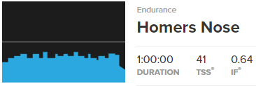

60 minutes @ Endurance Zone:

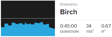

45 minutes @ Endurance Zone:
