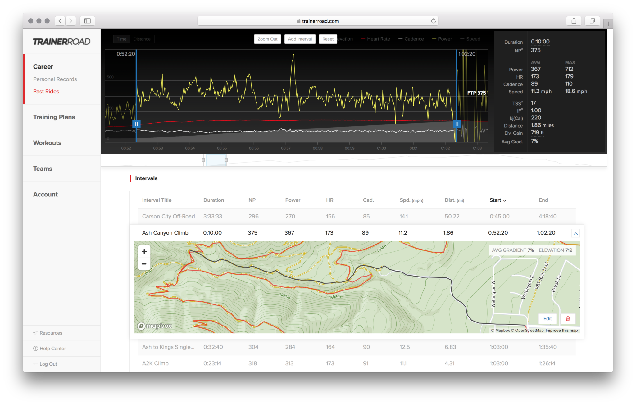

One of Keegan’s strongest competitors is current National Champion Howard Grotts. He’s known for his extraordinary climbing ability, and Carson City Off-Road started with a hard fireroad climb into a tight four and a half miles of singletrack climbing.
Keegan was hoping to go as hard as needed before the singletrack to keep Howard behind him, allowing Keegan to dictate the pace rather than Howard. The fight for position before singletrack is always important and comes at a great physiological cost, but this is especially bold considering they had a 50-mile course with plenty of climbing ahead.
This chase to the singletrack ended up being a 375w effort for 10:00 minutes, which is roughly what Keegan could sustain for an hour at the race start elevation, but they still had plenty of racing left. While Keegan didn’t end up getting in front of Howard going into the singletrack, the move was enough to give he and Howard a gap over the rest of the field.
At this point they weren’t even five miles into the race, but Keegan’s exceptional fitness already starts to show. After riding over and around Threshold for 10 minutes, Keegan continued to be able to cross his threshold an astonishing 141 times in the next 23 minutes on the Ash to Kings singletrack climb, spending just shy of 20% of that time above Threshold.
World class mountain bikers like Keegan have cultivated an incredible ability to recover quickly from hard efforts, and that recovery is accomplished without the need to coast. With fitness like this, Keegan can start races hard enough to cause a separation without fearing a premature blowup.

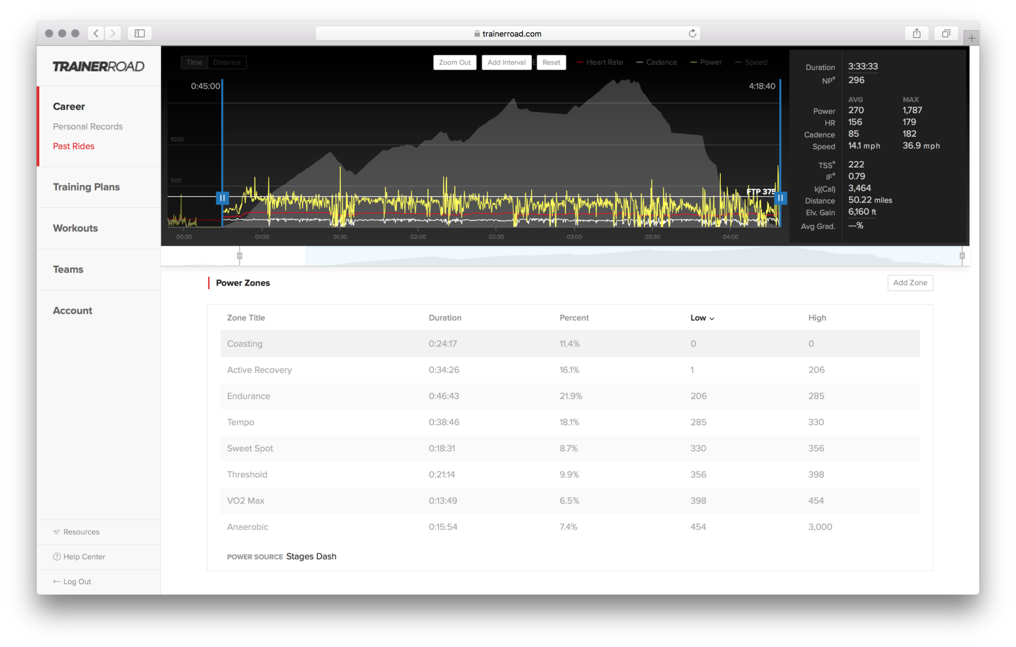

In our analysis of Geoff Kabush’s Dirty Kanza race, we noticed his rides mirrored that of many pro road racers in that they spend a surprisingly large amount of time coasting. Mountain biking, however, is a different story.
Keeping in mind the nearly 7,000 vertical feet of descending on this course, Keegan coasted for 24 minutes during this three and a half hour race. 10% of his race time may seem like a lot, but as a point of comparison, our CEO Nate Pearson coasted for nearly an hour and a half (26% of his race).
The reason pro mountain bike racers coast less than what you’d see in a road race is preservation of momentum. The variable terrain of a mountain bike race is rife with opportunities to lose momentum, but maintaining a certain threshold of speed throughout the course can help you carry speed through these undulations and save more energy.
However, looking at Keegan’s race file it seems that he still takes advantage of consistent descents to coast, and perhaps even more than average riders. Once again, the keen sense of kinetic energy is a common trait amongst successful racers.

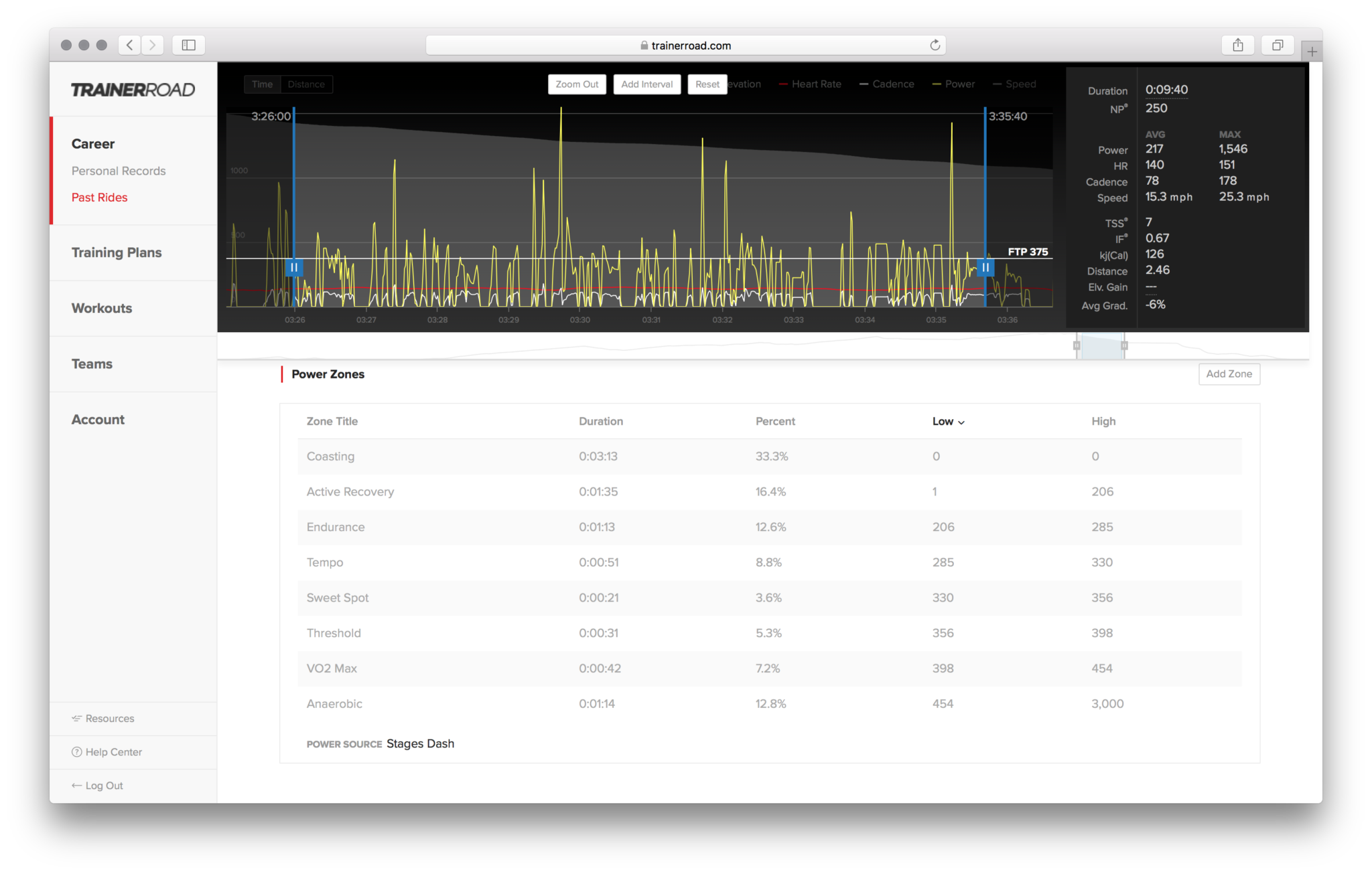

Descending Isn’t Supposed to Be Easy
Whereas average riders tend to segment their races into large “climb” or “descent” blocks, pro riders see things at a greater resolution. Keegan’ descent on the Sunflower Hill singletrack shows that while he spent plenty of time coasting, he was still looking for every potential advantage the course presented to him, and he was willing to work for it.
Motorsports racers commonly refer to this practice as “digging for speed”, in which they look at the course from a perspective of “How can I maximize my speed on every inch of this course?”. Instead of simply looking at a descent and letting gravity take care of the work, your mind is running a constantly refreshing feedback loop of speed maximization. This is most evident with how good racers brake so late into turns. If all you need is 10 feet of maximally effective braking to slow yourself to the speed needed to negotiate a corner, why start breaking 50 feet earlier with marginally effective braking?
Coming out of the turns, you can see that Keegan is still concerned with maximizing his speed over every foot of the course. His hard-earned fitness leaves him unafraid to accelerate hard out of every turn, and by doing so he spends less time accelerating to his max speed, and more time sustaining that speed.

Time in Zones: Pros vs. Joes
World Cup Cross-Country racing are going to shorter, harder loops that aren’t open to the public, so it’s exciting to have these endurance races from Epic Rides that allow us to compare the performances of average riders to pro riders and see how exceptional they really are.
Looking at the time spent in each power zone for Keegan vs. Nate, you can see Keegan spent nearly 40% of his race “filling in the gaps” between hard efforts with Tempo, Sweetspot and Threshold work. In this respect, his effort is much more consistent than what you see from an average rider, with Nate having only 20% of his time spent in these zones.
Even more interesting is that Keegan spent 14% of his time in the Anaerobic and VO2 Power Zones while Nate spent just under 5% of his time there.
