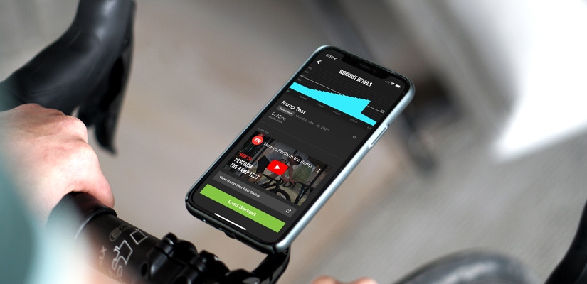

TrainerRoad’s preferred FTP test is our Ramp Test. The Ramp Test begins with a 5-minute warmup, and then every minute after that, it gets slightly harder until you cannot maintain target power any longer. 75% of your best one-minute power during the test is used as your FTP. Our data shows the Ramp Test results in the most accurate and useful FTP estimate for the majority of cyclists using TrainerRoad. Since it is quick (normally about 25 minutes, including warmup and cooldown) and less stressful, it can be taken frequently to track changes in your fitness.

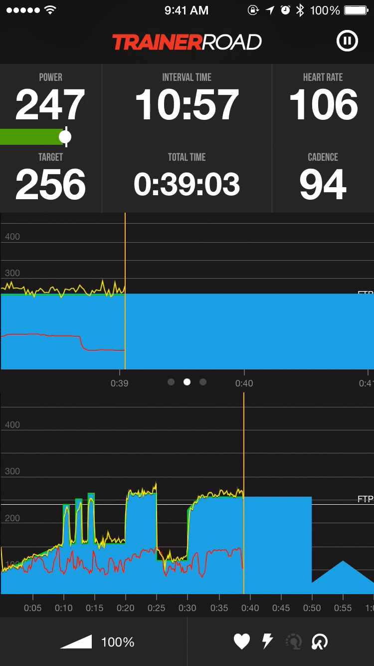

20 Minute FTP Test
The goal of the 20-minute test is a steady-state effort—one that sees minimal fluctuations in power output. It will take an hour, including a warmup and cooldown. Pacing a 20-minute FTP test is crucial. This is a strenuous effort, so make sure you’re well-rested.
Begin with a warmup for 30 minutes, and don’t be afraid to throw in a few short steady-state efforts. Once you’re ready, start your test. If you’re doing it outside, hit the lap button on your head unit when you start and finish. It should feel like you are trying to sustain your highest power without blowing up. Your FTP is 95% of the average power of the interval.
How To Pace a 20 Minute FTP Test
From the start, build your power quickly but controlled, then hold it high and steady. Avoid large surges near the finish, which can artificially lift your power number, skewing your results. The simplest advice is don’t go out too hard. At the same time, you don’t want to go out too easily.
We recommend riders reassess their pace every 5 minutes during the test, and that any adjustments be just a few percent at a time. Many athletes ride these long efforts too conservatively and surge their power during the last 2 minutes; this skews the results and should be avoided. You should arrive at the last 5 minutes just able to hang on and maintain steady power.
When pacing a 20-minute FTP test, pay close attention to how you’re feeling during the last 5 minutes of your test. If you paced accordingly, you should be just hanging on. If you’re able to elevate your effort substantially at the end, it’s a sure sign you didn’t pace well.

Ramp Test
The beauty of the Ramp Test is that it requires no pacing strategy. Instead, the key is to absolutely empty the tank. Follow the intended target power as close as possible for as long as you can. Even a few seconds more when you think you are done can yield meaningful data, so you should ride until you physically can’t maintain power anymore. You should not make the conscious choice to stop- instead, your legs should override your brain.
You don’t need to do any openers prior to starting your Ramp Test. While doing some openers is a great way to prepare your system for hard efforts psychologically, we intentionally designed the Ramp Test not to require any additional preparation. You also don’t need to do an extra warmup before you start the Ramp Test; we’ve tested and found it did not alter the results in a meaningful way. The first five minutes are naturally very easy and will prepare you for the harder efforts.

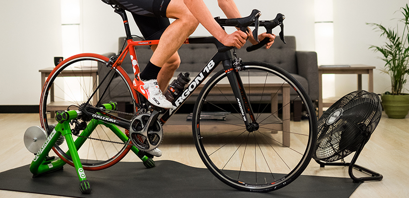

  6. Don’t forget about cooling. For indoor tests, a good fan is crucial. Place it at the base of your bike and aim it at your body, or put it front and center on its high setting. 75% of your energy goes into thermoregulation, and this is particularly important at high intensity.
