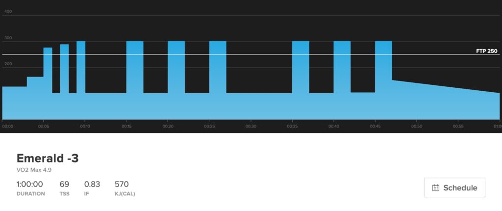

Emerald -3 is a sustained VO2 Max interval workout
Emerald -3 contains traditional style VO2 max intervals with 6×2-minute repeats at 120% FTP with 3-minute recoveries between intervals and an 8-minute active recovery between sets of intervals.
