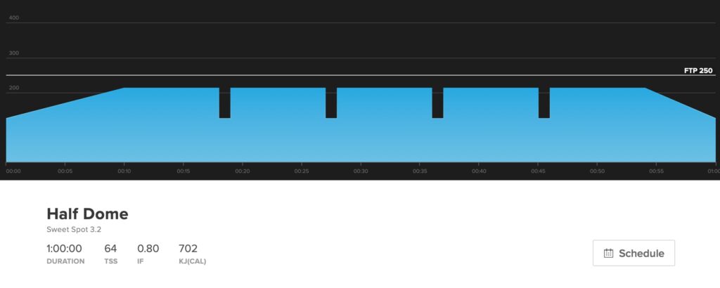

Sustained Power
Found in Endurance, Tempo, Sweet Spot, and Threshold training zones, these workouts include comparatively long intervals—in some cases lasting nearly the entire workout.
