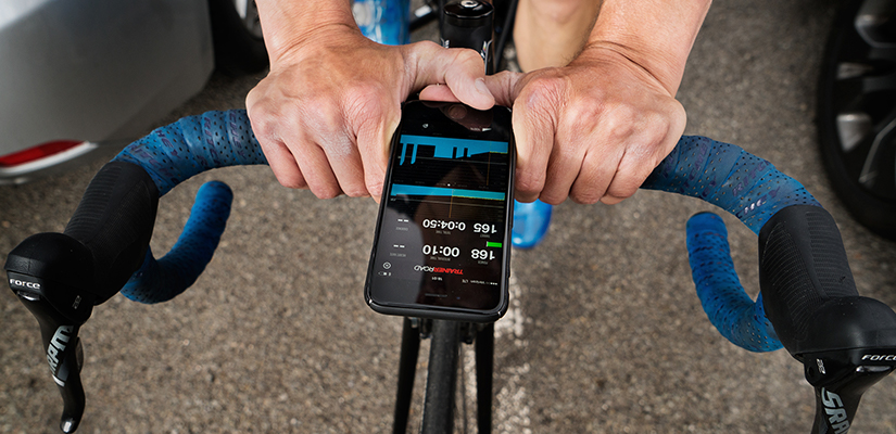

Start off by trying to make your warmup and pre-race routine as consistent and replicable as possible. Using a trainer for your warmups is one of the best ways to accomplish this. Some races will be held in locations or under circumstances that will be far from ideal. Lack of space, busy roads, inclement weather and distractions are all variables that can throw a proverbial wrench in your spokes before the race rolls out. A trainer fixes this, giving you the chance to define and control your warm-up process.

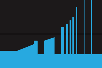

Fast starts, short/intense efforts
pahrah
Pahrah
This warmup is perfect for CX, MTB or Criterium racers. If you’re event is going to be littered with short but intense efforts, Pahrah’s for you. Starting with a gradual ramp and 1-minute effort at 80% FTP, you’ll then get a chance to collect yourself before a 80-90% 5-minute ramp.
After this primer, the warmup becomes more event-specific with decreasing duration 45-second to 8-second intervals offset by increasing rest intervals. The intensity of these intervals grows from 120-220% FTP, making sure you are familiar with the demands of a fast-paced start and short, intense efforts.

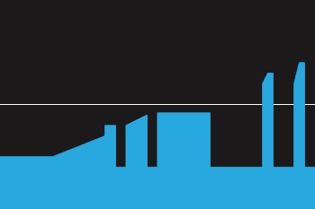

General or Varied Races
Laurel
laurel
If your race isn’t filled with particularly short or long efforts, but features a variety of durations and intensities, Laurel will do a good job of preparing your body for the task at hand. Road racers that are expecting a fast start, endurance mountain bikers or racers that are just looking for a varied yet comprehensive warmup are who Laurel was made for.
The interval structure of Laurel is a bit different than the other two warmups. Laurel starts with the same ramp to 60-second 80% FTP effort, but then mixes things up with a 2-minute ramp from 80-90% FTP and a sustained 5-minute effort at 92% FTP. To balance out the sustained nature of that interval, Laurel wraps up with two 6-second efforts at 120-140% FTP. The varied nature of this warmup will be sure to give you a small dose of the efforts you’ll soon face.
