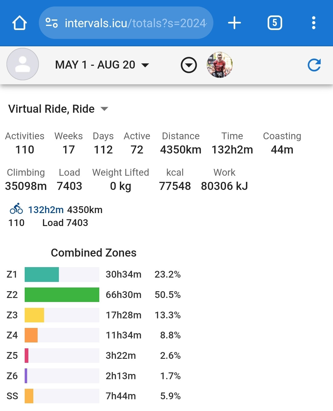

In the same time period I did less total time than you but spent 44 minutes coasting.

you rode more than me, but your coasting time is too high. I’d start being more consistent on the pedals. It’s not because it’s downhill you stop pedalling.
Also, you have very little intensity IMO. Being polarized is one thing, not doing intensity is another. You have 56.9% on Z1, which is recovery and produces little to no adaptations. Add to this 42 hours of coasting, and your training isn’t very effective.

And there’s nothing wrong with coasting. What I’m saying is that it isn’t effective as a training tool. OP “asked” why he has the same FTP numbers after 3 months with TR. Well, coasting a lot doesn’t help with that.

The OP barely did any zone 2. He coasted around a lot at <50% of ftp. No wonder he got his result.
