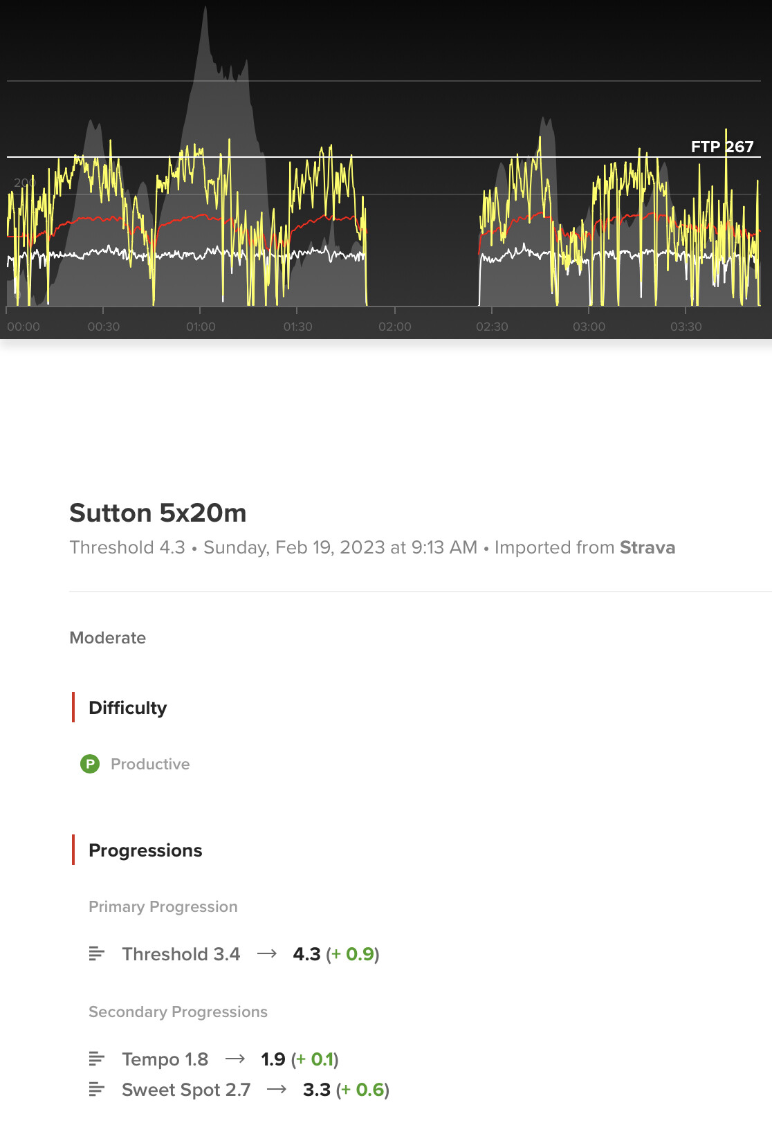

For me, if I’ve done NO threshold indoors for months, and then do a 5x20m outside, I want my PL’s to recognise the effort, so will associate.
Interestingly, I get different views of progressions from desktop and mobile (beta) : 4.3 vs 6.8

As for the difference in Workout Levels you’re seeing: that likely has to do with something funky in the beta app – on the production app, everything seems to be normal, so I’ll relay that info to the beta team so they’re aware of it.
