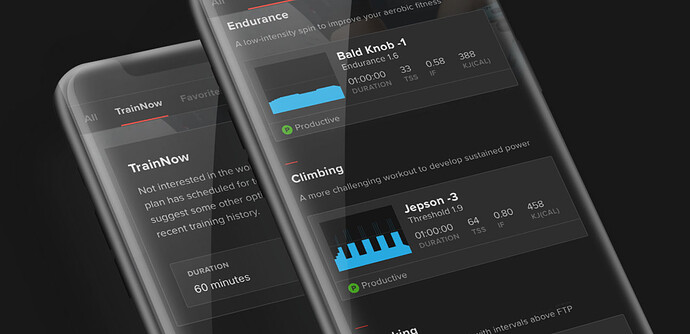

In a less progressive or focused way? Can you please elaborate? What does that mean exactly? How is it accomplished? I think there needs be a much more “focused” explanation of how TrainNow works, what it can achieve, how it interacts with Adaptive Training, how outside non-TR workouts interact and affect bothe Train Now and Adaptive Training. I’m trying to get excited about Adaptive Training, but I can’t, because it’s not clear how it interacts with Train Now and unplanned, non-TR workouts. Everything’s a little hazy.

Think of it this way: a training plan’s goal is to develop a particular balance of discipline-specific abilities within a pre-determined period of time (the training plan’s length), for a particular goal (success in an event or ride type). This means the progression of difficulty from week to week, the specific energy systems targeted within each workout, as well as the interspersal of rest weeks and easy days are all designed strategically to work together with that particular endpoint and goal in mind.
TrainNow is by design more open-ended. It uses its knowledge of your current fitness to suggest workout options that will be productive for your fitness overall, without being so hard that you’ll be likely to have trouble completing them. It’s perfect if you’re not working towards a goal, since it lets you choose what specific energy system or interval duration to focus on each day. But it’s not working with a specific goal-centered focus or designated timeframe like a training plan. As you complete TrainNow workouts, your fitness will improve and the workouts will gradually become more challenging to meet your growing abilities. But that day-to-day progression is not driven by any motivator other than the simple concept of presenting you with a productive training session.
