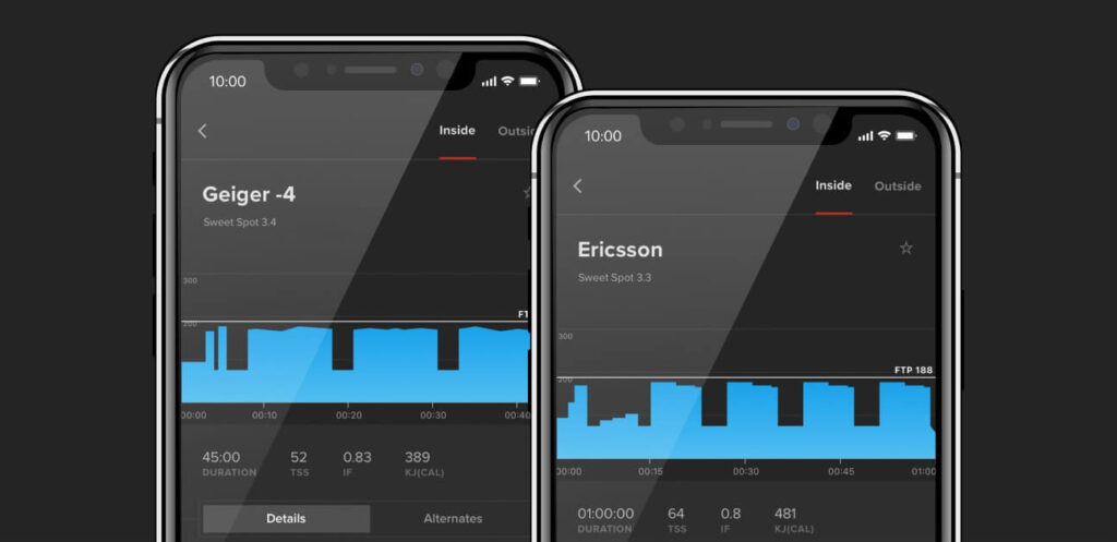

Given the benefits of Sweet Spot work, you may now be thinking when and how should I integrate it into my training? Firstly, if your aim is to get faster, know that Sweet Spot work can be valuable in all phases — Base, Build and Speciality—of training. Athletes also find it effective when entering into a “re-build” phase to achieve a second peak in a season. Secondly, understanding the efficacy behind Sweet Spot work helps shed light on a number of Coach Chad’s most recent training plans updates.
Try Plan Builder
The Sweet Spot Base plans have already seen these changes, with many of our Build and Specialty plans soon to be released. The logic here being: many of the same aerobic adaptations achieved through longer, lower-intensity rides can be achieved in less time training in the Sweet Spot power zone. For example, the former Sweet Spot Base plan saw a 150-minute aerobic endurance workout on a Saturday; in the revised plan you’ll find a 80-minute Sweet Spot weekend workout instead.
