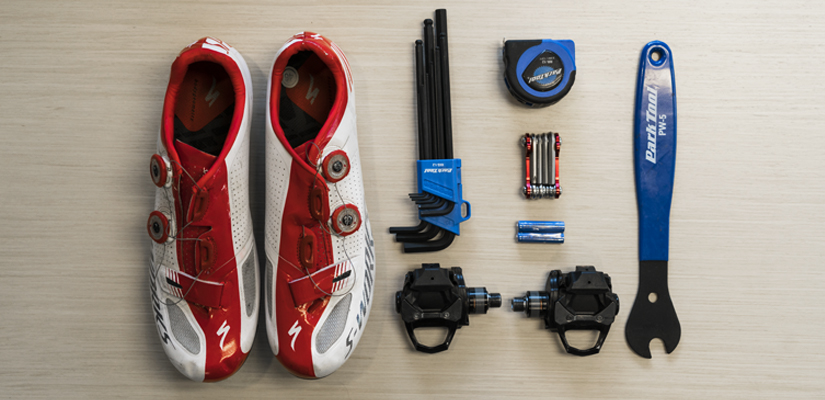

You will need to remove the existing pedals from the gym bike using an allen wrench or a pedal wrench to use the gym bike with your pedals. We recommend bringing both, and also bringing a multi-tool (like a leatherman) in case you need to adjust the seat. Keep in mind you will remove the pedals like you would on any normal bike; always turn the pedals backward. If you really want to geek out, measure the seat height on your bike and bring a tape measure to set the gym bike to the same height.
Check in with the gym to see if they are alright with you tinkering with the bike, too. Then once you equip the bike with the power pedals, you’ll be ready to pair the pedals to TrainerRoad and rock n’ roll.
Athlete 1 needs:
  • Pedal-based power meter (Garmin Vectors, PowerTap P1s)
  • TrainerRoad for iOS/Android
  • Gym bike
  • Allen wrench/Hex key set
  • Pedal wrench
  • Portable fan*
  • Pre-grease pedals*
  • Tape measure*

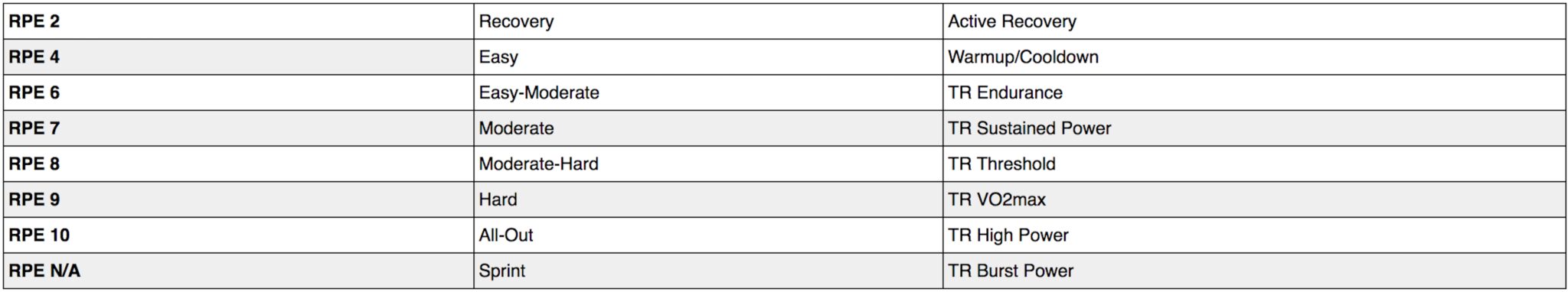

Using a gym bike alongside TrainerRoad without the ability to measure your power output leaves the option to train by RPE. Measuring your effort level using RPE is tantamount to doing your workouts based off feel. More experienced cyclists will have a better grasp on how their RPE levels stack up against their actual power zones.
Those with less of a grasp can reference the chart below to understand which RPE levels correspond to which power zones. We want to know this conversion so we can perform our workouts approximately at the intensity prescribed by the workout.
Regardless of experience level, each athlete should examine their workout(s) to determine which RPE level(s) you’ll perform your workout at.

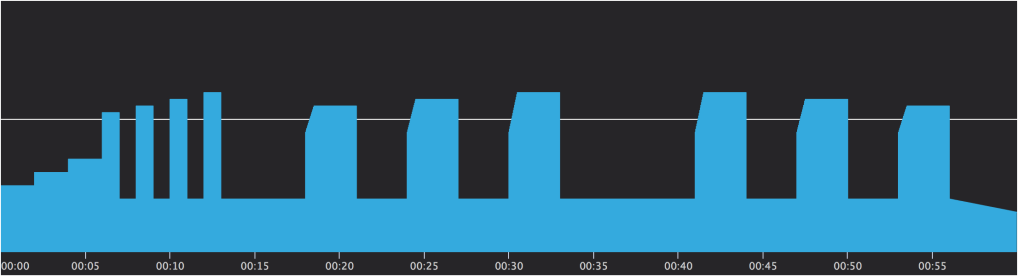

Huffaker is 6×3-minute VO2max intervals done in 2 sets of 3 intervals where they quickly ramp up to a very high but sustainable and repeatable intensity between 110-120% FTP.

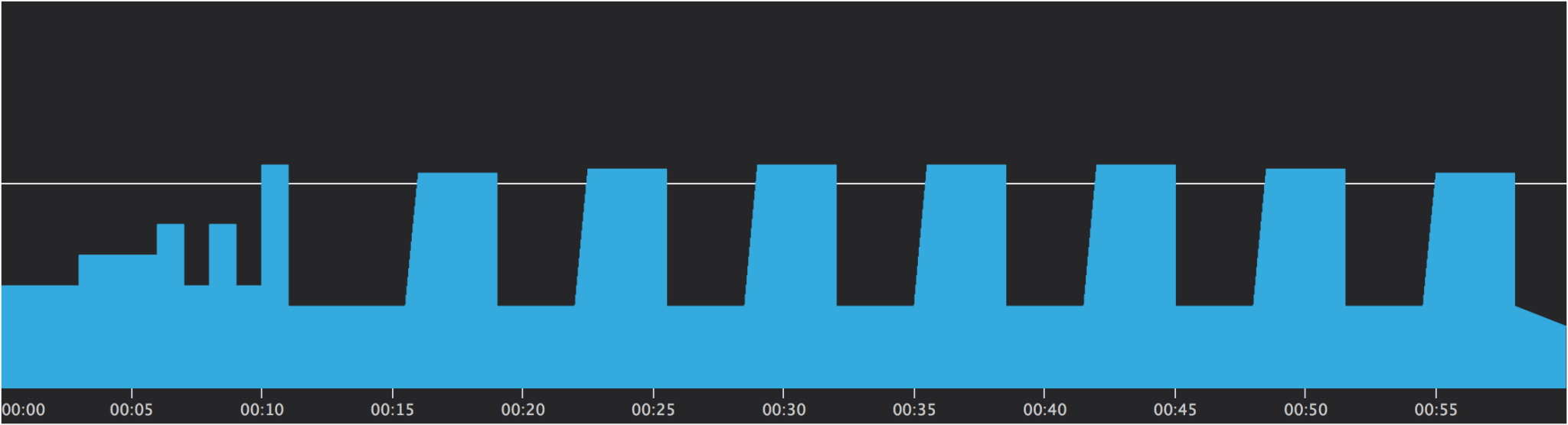

Mount Deborah is 7×3-minute intervals at 105-109% FTP with 3.5-minute recoveries between intervals.

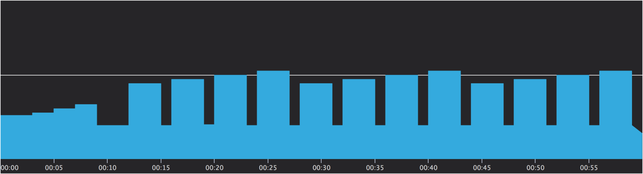

Haeckel is 3 sets of 4×3-minute Threshold intervals that can be treated as slow-force work. They step up from 90-105% FTP in 5% increments and all recoveries are 1 minute long.
