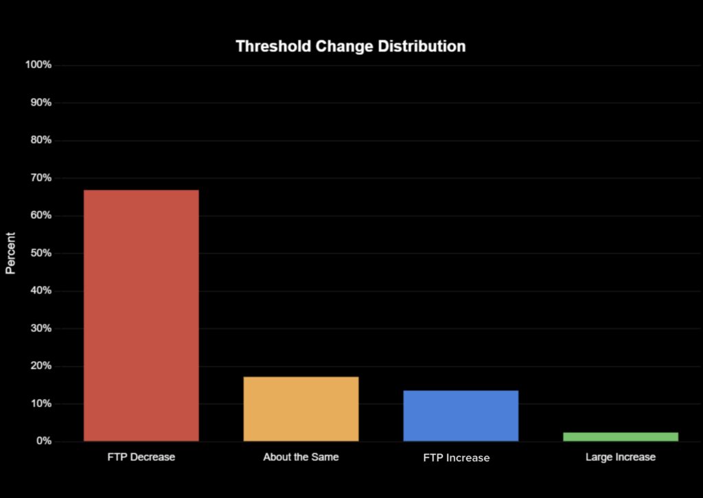

Early in the forum TrainerRoad AI beta thread (it was private), there was an idea that the new AI FTP Detection overestimated people’s FTP’s and everyone was getting an increase. We saw a few people post big +10% FTP increases, and people ran with that as fact.

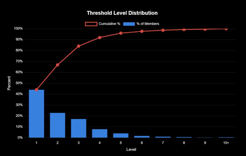

Because we’re recalibrating to about a level 3 threshold workout being able to be completed in the expected zone, if you had an athlete level higher than that, your FTP would increase, and lower than that, your FTP would decrease.
Threshold Level
- < 3 FTP Decrease
- 3-4 About the same
- 4-6 FTP Increase
- 7+ Large Increase

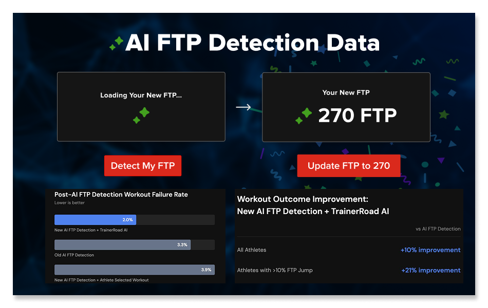

We measure your first workout after an AI FTP Detection, and we see improvements in fail rate and expected outcome with our new AI FTP Detection + TrainerRoad AI vs the old system.
Our failure rate for the “hard” zones is sitting right at 2.0%, which is right within our targeted failure rate (we calibrate for some in the predictions).
That’s a 33% improvement compared to the old AI FTP Detection!
The bottom bar shows athletes who used the new AI FTP Detection, then ignored TrainerRoad AI and chose their own workout. Their failure rate is about 2x as high as compared to letting TrainerRoad AI choose it.

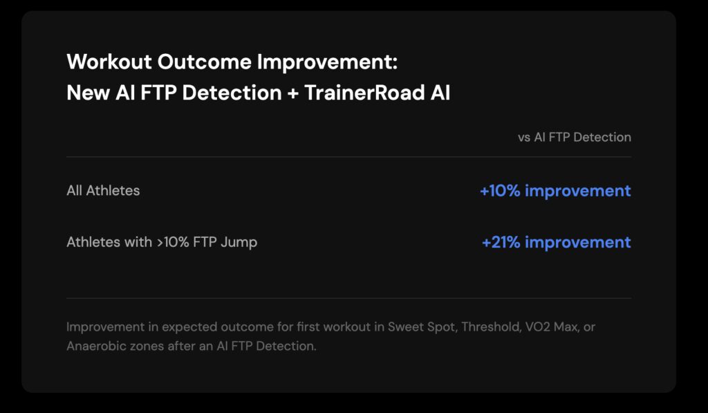

And for the expected outcome, we see an increase in performance as well. And interestingly, we see a larger percent improvement in athletes who have a LARGE FTP improvement of +10%.
We’ve seen this in reports, too. During the beta we’ve consistently had feedback of “No way I can/should do these workouts. They are too hard/easy for me”. Then, when the athlete actually tries the workout, it feels perfect!
This is because the AI is just trying to incrementally increase the watts you’re doing. So even though you might have a big FTP bump, the watts you’re doing for your intervals are still similar.
