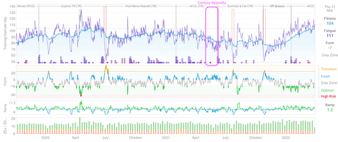

Here’s my fitness (e.g. performance manager) chart from intervals.icu since Oct 2019. The purple section is when I did the Century Specialty plan. The decrease in Training Load per Day (e.g. CTL) is due to the drop in volume in the plan to regain freshness and peak.
