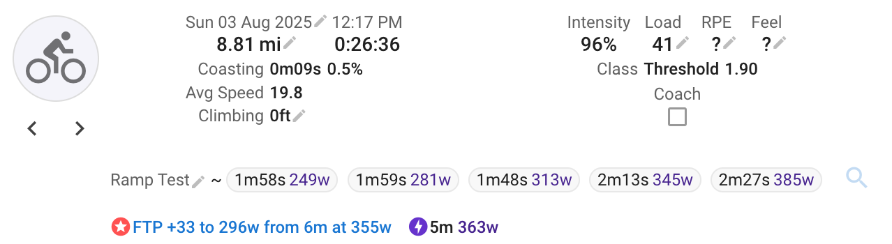

Hi there! Been using TR for all of this year and have seen amazing gains! Started at 234 and recently got to 296 on a ramp test which I am super thrilled about.
My post is to discuss my experience with AI FTP detection. When I began training, it seemed to work well, and I was seeing pretty good gains. After a while, not too surprisingly I saw my gains starting to slow. This logically makes sense. Each increase in power is harder to achieve and potentially requires more discipline and time on the saddle.
The last month or two I have been doing many more outdoor rides as well, many of them the prescribed workouts. Although I felt that I was getting stronger, my AI FTP detection had really stalled out. I was seeing almost no gains for two months straight.

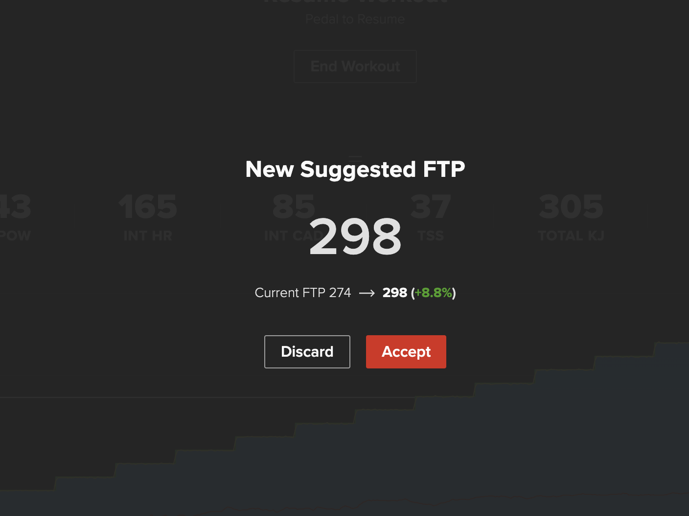

While taking a week off to visit family, I decided to come home fresh and do a ramp test. My current AI FTP was sitting at 274. I have done ramps in the past and do not believe I am one of these people that are really good at them. I can push pretty hard, but they have definitely kicked my butt in the past. Was hoping that I’d get closer to 285 FTP, but I found I was still able to push it and get to 296. This is around a ~9% difference between ramp test and AI detected FTP. I even felt like I had about 1-2% more in the tank and could’ve pushed it for another 10-20 seconds.
In this situation what should I do? Take the ramp test value or AI? I am guessing my FTP lies somewhere between the two, but I’m not sure where.

Hey @burnett2k,
Good question!
This is what makes Ramp Tests a bit tricky to decipher and employ compared to something like AI FTP Detection.
A Ramp Test is a single, relatively short effort (~15 minutes in your latest case) that can have different outcomes for a pretty large number of reasons, whereas AI FTP Detection is based upon many efforts of all different types and durations.
While your FTP has an effect on the workouts you are prescribed, it’s not the only factor. Your performance during those workouts has a major role in your overall progression. So while you may be able to continue training with an FTP set anywhere between those two figures (274 & 296), there is certainly an optimal place for it to be, which is based on your current abilities and recent training history.
The magic happens when everything is really dialed in and we use your FTP alongside lots of other data to help us pick the right workout for you. If you change your FTP, the outcome could change, and even though the workouts you get might still be doable, they likely aren’t as optimal as they could be with the right FTP figure. :magic_wand:
A couple of notes I pulled from your calendar that seem relevant to me are your Picuris +3 workout on July 15th (5x12 at 254-265), and Wright Peak -5 on July 17th (2x30 at 257-260), which left you really fatigued for the rest of the week. This tells me that your FTP is likely closer to the AI estimate than your Ramp Test results.
I typically try to sway our athletes to avoid taking Ramp Tests, as they don’t bring much to the table given the tools we have available now. The system we have in place works really well, and we believe that it’s currently the best option for all athletes.
If you’re the type who really likes looking at data, double-checking things, testing tools, and using tangible data for peace of mind, you could always take on a few 20-minute tests each year, but, similar to Ramp Tests, those have their own shortcomings and challenges as well.
I know that as you progress, fitness gains are harder to come by, and we’re always looking for ways to push that number higher and higher, but just know that you’re on the right track! Finding a different source of data that gives you a higher FTP might be compelling to follow, but that doesn’t mean that it’s going to be the right path to go down.
Let me know your thoughts on this, and if you have any other questions.
Best of luck with your training! We’re always here to chat if you need us! :slightly_smiling_face:
