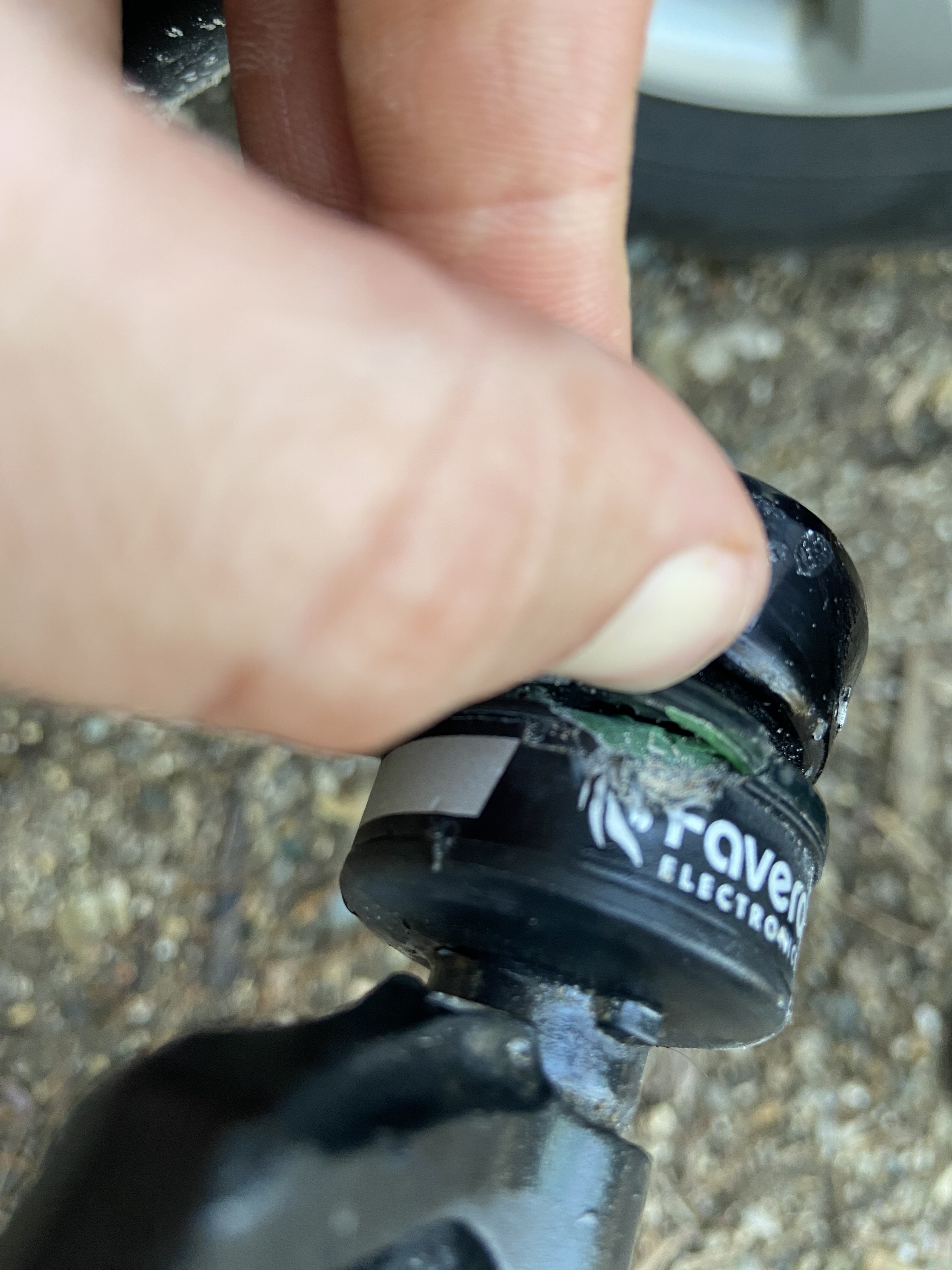

I just got new winter shoes and they are rubbing on my spd converted unos :frowning: i don’t really want to chop up the shoes. Is a little rub a big deal? Should I use this to just bite the bullet and get the pro MX pedals?
I’d take a razor to the rubber before spending $500 on new pedals… The rubbing could throw off power readings as you’re no longer putting all the pressure through the pedal but onto the pod instead.
Fair point I really don’t want to spend that much either. It’s barely rubbing the side so I may just try to trim a tad off. The manual says it needs 2mm of clearance but idk if thats really necessary or not.
