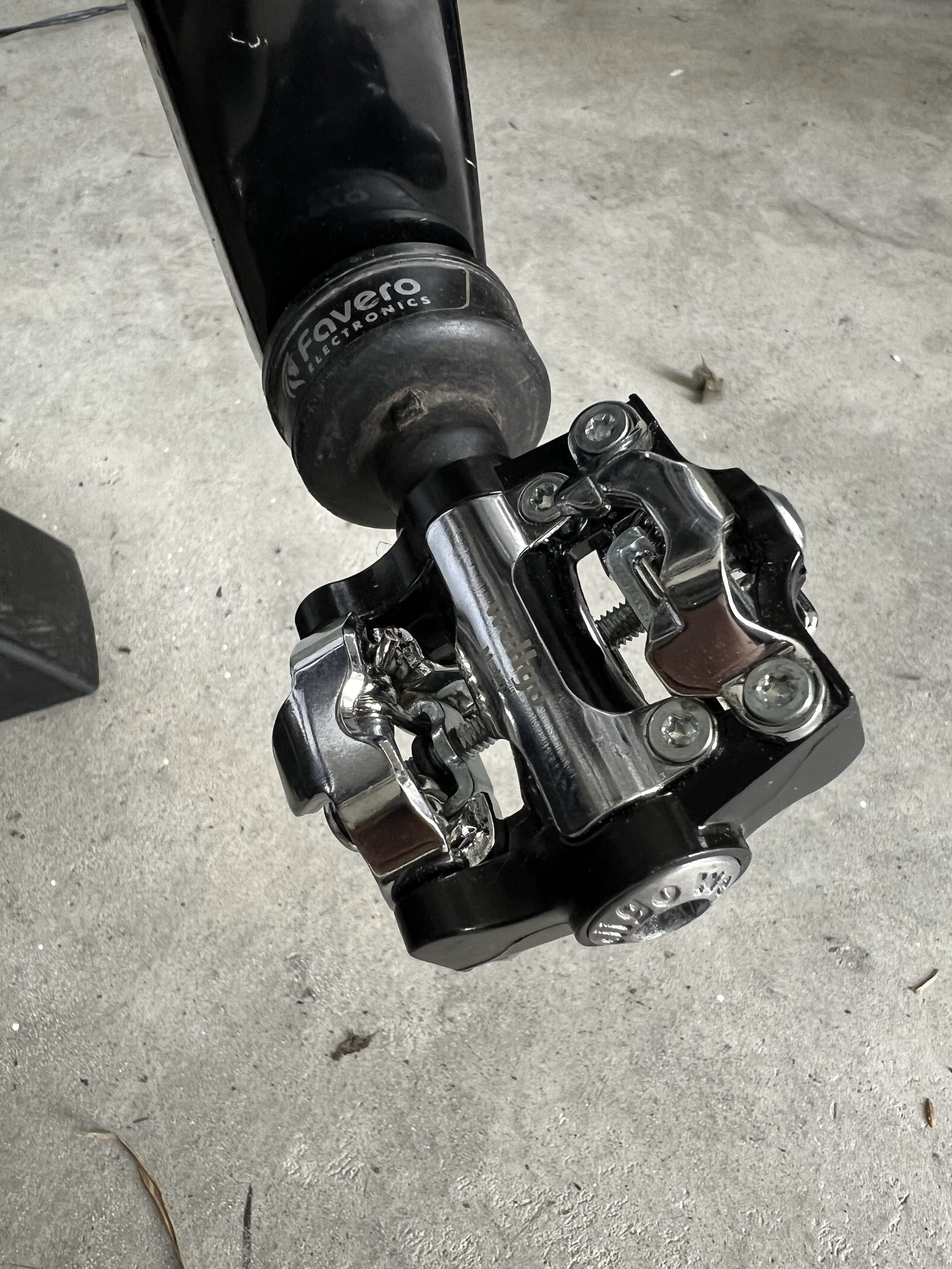

Confirming that the Wellgo WAM-M19 seems to work. Very easy direct swap. Good option for NZ where I couldn’t find any places selling xpedos or bontragers.
I’ve done a quick spin on the trainer and the numbers look ok at first glance. About 2% difference, but I need to dig into that a bit more to confirm.
Edit: I swapped back to the Favero bodies and the difference between trainer PM and pedals is consistent across pedal bodies. So I think the Wellgo hack is producing close power readings.
Couple of caveats:
  • I had to remove the favero steel oil retainer ring as it doesn’t fit with the Wellgo rubber seal on the crank side of the pedal. I think the rubber seal will still provide the same level of weatherproofing as on the original Wellgo pedals. But I’m a bit worried that it might abrade the plastic favero pod over time, as the rubber seal spins against it where the oil retainer didn’t.
  • I notice that the Wellgo axles don’t fit into the Favero pedals. The Wellgo axle seems to be slightly larger than the Faveros. I wonder if this could lead to the bearings slopping around slightly in the converted pedals and wearing out faster. Time will tell I guess
