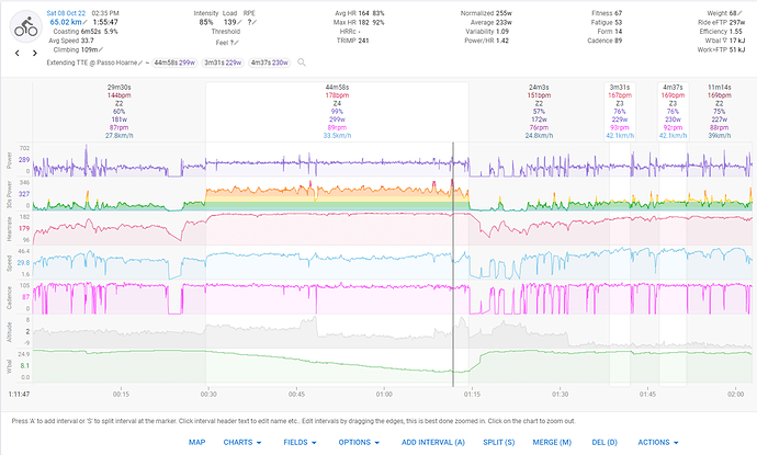

Just curious, why would you see the time in zone for just an interval?
Because I do a lot of long intervals? And lately, an extra 30-60 minutes of low endurance to keep building overall volume and load (CTL).

I do even longer intervals for about 45-60min etc.
For me is this enough information for longer intervals in combination with the power page for the overall Time in Zone.
The latter, and I did a bunch of lab validation to adjust the needed variables, and then had done a few over time. The model actually holds remarkably well. But yes HR can be influenced by other factors, but over time you can track.
Thanks is your graph from overtime or only per ride?
The one i snapped was for a ride, but i track trend as well though it has some work required to knock out rides that can skew the data set. What I have found is a very low power recovery ride where your HR never gets near LT1 can mess up the overall dataset.
