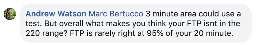

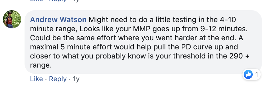

I’ve seen some ridiculous things on the WKO Facebook page where it felt like people who doubted the Power Duration Curve were subjected to this weird gaslighting (as the kids call it). I particularly remember some guy who’d actually ridden 60 minutes at one wattage but was encouraged to either accept an mFTP that was lower, or go away and come back when he’d done some 30sec - 2min max testing. All because the PDC values for shorter intervals were affecting the curve.
Every time, the answer is the same. Test your shorter power. Test your 20min power. Test more. Test test test test test. Feed the curve.
