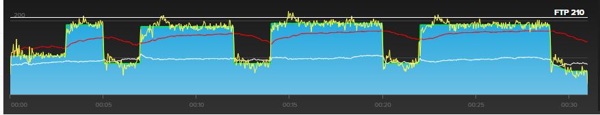

So, i’ve tried using my phone now instead of the laptop and it worked fine for one workout, then on yesterdays one it worked until the end of the first 12 minute interval, then it just wouldn’t drop down after. Tried turning it off and on again, repaired it, spin down and still wouldn’t release. Fast forwarded and plodded on for the second interval and rather than fluctuate with the required interval powers, just tried to pin me at 305W?
Ended up digging out an old phone and pairing that and it worked okay. This is highly fustrating though.
Capture
