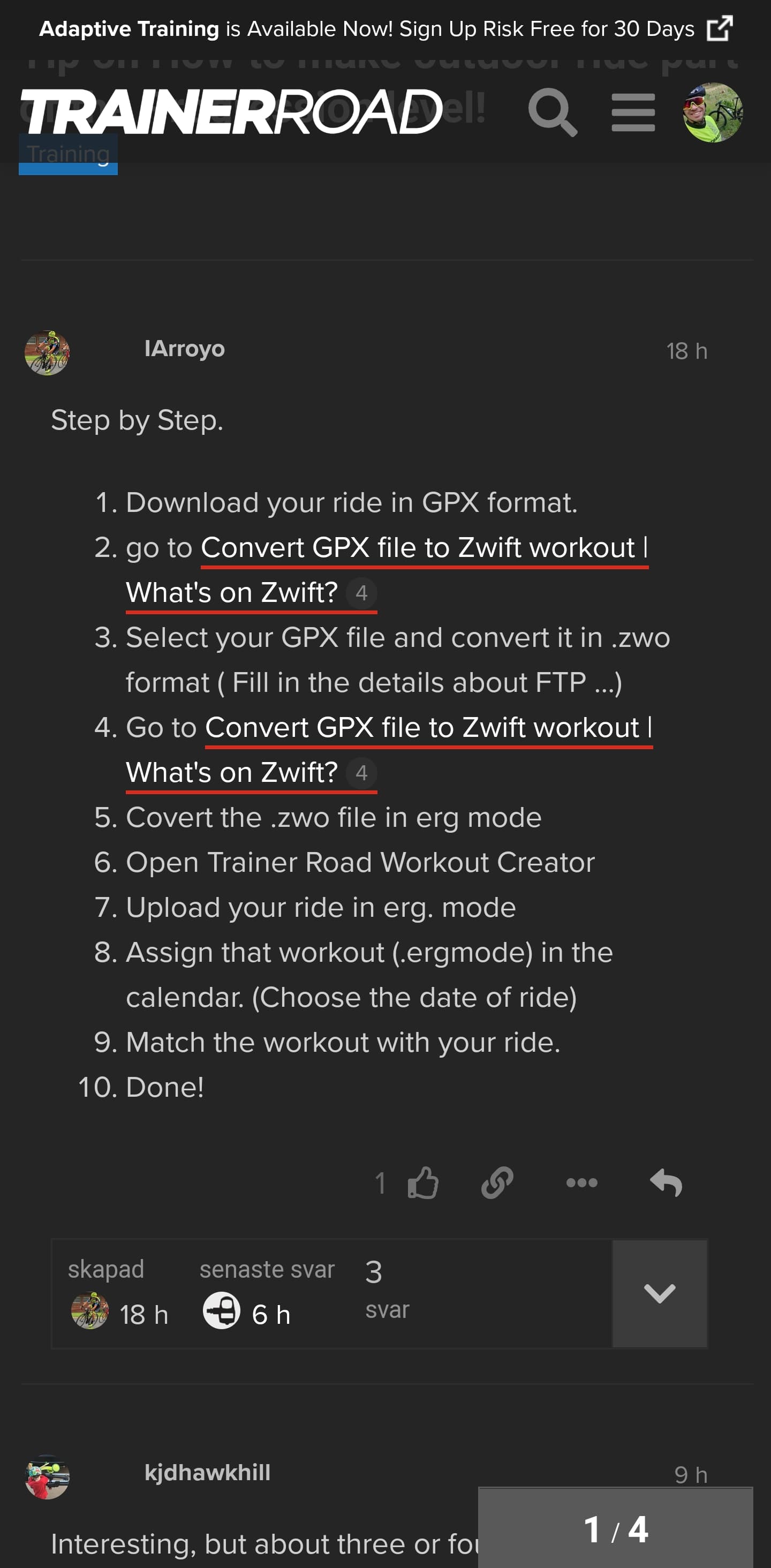

You can do it like this!
Heads up: Workout Levels assigned to custom workouts aren’t fully supported yet, but a super high priority for the development team that will go along with accounting for unstructured rides. You may get some wild classifications from those custom workouts currently, sorry for the delay while we work on making those reliable and consistent!
