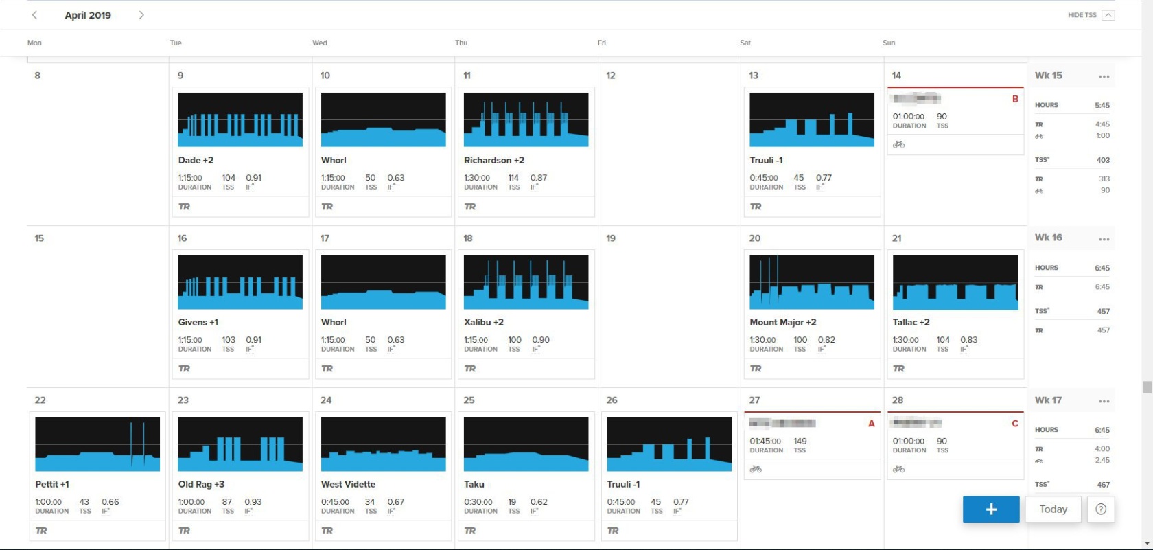

can you take a look at the last weeks of speciality before the start of type A? Would you change something or look good?
Looks pretty good to me!
