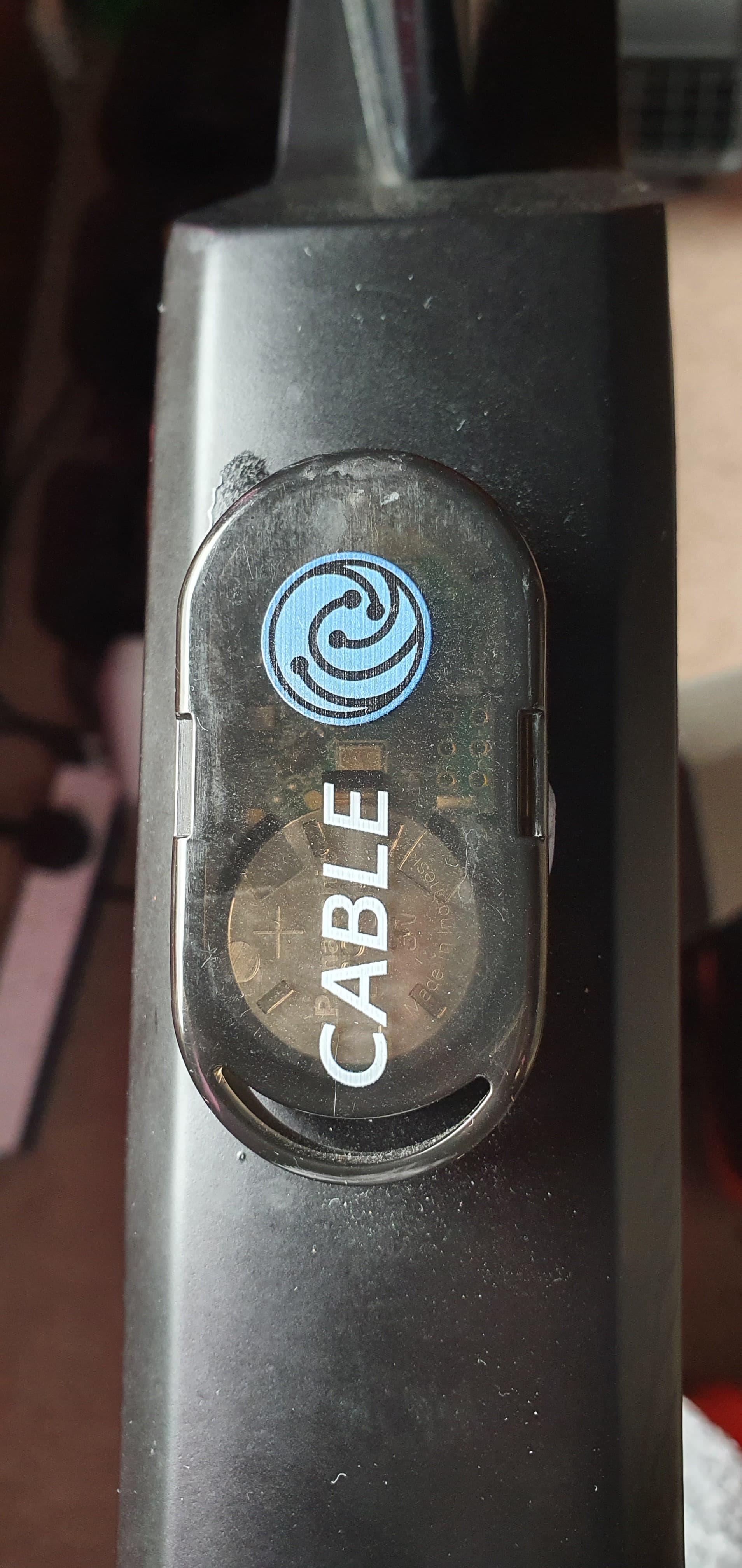

unfortunately bluetooth connections are singular so unless your device (trainer or pedals) broadcasts multiple signals you can only have one connection per. Since TR is using both the trainer and the pedal connection, you’ll need to use the ANT+ protocol for any additional connections. The good news is Ant+ dongles aren’t a huge investment. The garmin one sells on Amazon for $34US or about the same as a wheel or cadence sensor. Should work with Macbook fine.
Or you can use an NPE CABLE to convert the ANT+ signal into a second Bluetooth signal. That’s how I run TR and Zwift together and it works perfectly.
