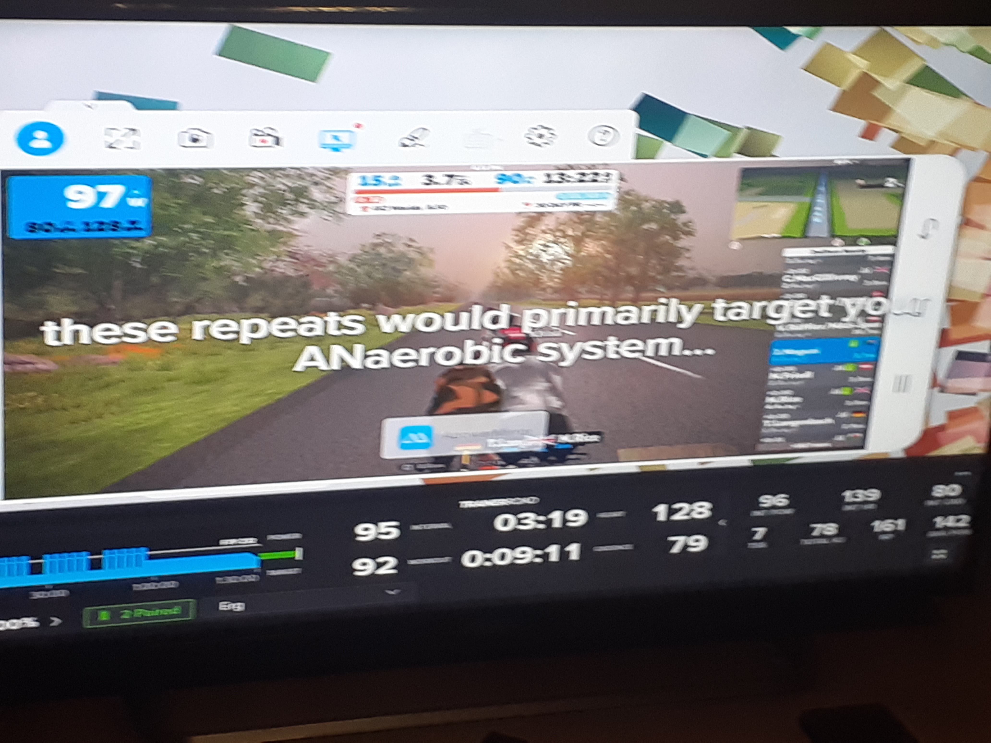

Works perfectly on my Windows 10. I used it about 10hours ago. I have Zwift on my cellphone then link the phone to the tv Monitor and TR on windows 10 using Ant+. When I run both Zwift and TR on the PC I get some dropouts.

I was trying to do the TR workout in erg and watch myself ride around in Zwift. Wouldnt play together. If I was connected to one it wouldn’t connect to the other.

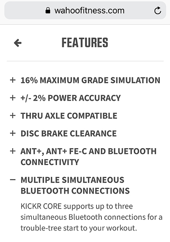

Dug into it a bit and looks like the Kickr Core has the ability to simultaneously connect up to 3 Bluetooth connections. So, that is why it is working for me. Sorry if I got your hopes up.
That capability was added recently via firmware update and is only possible with the Kickr18 and Core models. I expect other trainer makers to follow suit, but that will be a bit unfortunately.
