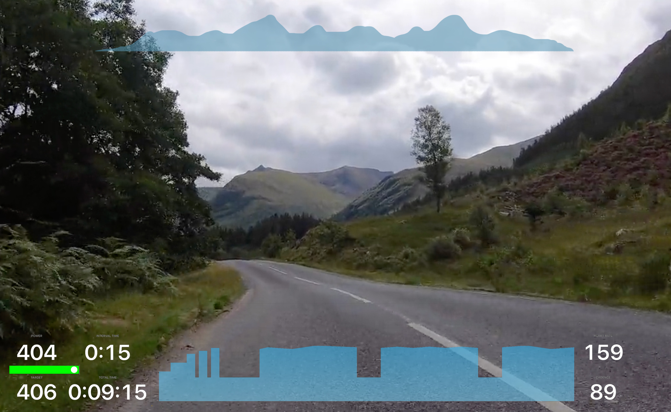

I’ve been on TR for a bit and just discovered Fulgaz this last week. Riding up famous passes was the coolest trainer experience I’ve had.
I might be the only one, but this is just begging for a TR video integration option, elevation included. Maybe something like this, but more nicely integrated? This was a quick 5 minute photoshop.
