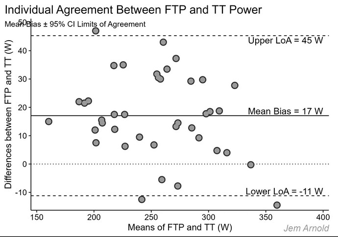

And TR abandoned it as their recommend way to set your FTP when they introduced aiFTP detection. Additionally, as the image I linked shows, it is rather inaccurate.
I would not consider it to be “the absolute truth with no question.” because of this and even TR has said that it wasn’t without issue and worked for some athletes but not all.
I’m just going to start linking this post from Pbase every time one of these threads start :joy:
