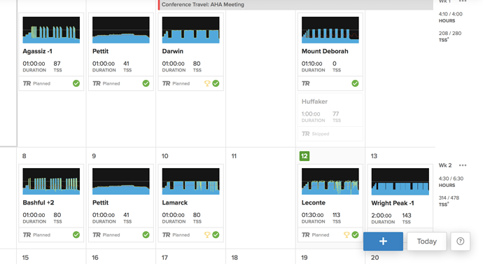

The last weekend before Christmas, I did poorly on Mary Austin -1 and the Sweet Spot workout on Sunday, and decided that rather than taking the trainer and bike on a trip with my partner and set up at her folks house, I’d just do some maintenance workouts (some by RPE on a gym bike) that week and then do some hard workouts the following weekends and a maintenance workout every three days the week after during which I was traveling for a conference.
The plan was to then jump back in with the hard week this last week. On Tuesday, I had to skip an interval of vo2max and backpedal during the later intervals (5 seconds each) of Bashful +2 (I think?) Similarly, I had to backpedal plenty of times during Lamarck. I went on another trip last night and just did Leconte. Thinking that it was a while since I completed a planned hard workout, I turned down intensity 3 percent from the outset. Nonetheless, I collapsed completely in the fourth interval having to backpedal lots. Same in the sixth interval.

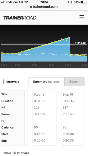

If you look at your ramp test you only lasted 20 secs at the next interval, your last full minute gave you the 240 ftp.
You’ve also been doing a full metric ton of work since September by the looks of things, were you skimping on your recovery weeks?
You’ve obviously got a huge capacity for work so no reason why you can’t see decent further gains, just reign yourself in a bit! :blush:
Oh, this is good information. Because just straight up my best 1-minute power also results in a 240 ftp if put through the formula. For some reason, I was under the impression that it’s the best 1-minute, not the last full 1-minute (and hence that those 20 seconds are crucial). But I may have misunderstood how it works!
Yeah, it actually looks like you managed to last 35 seconds in total for the very last interval but your power decayed so you were actually lower than the previous one.
Best one minute was 321 against target of 326
Last incomplete interval 319 against target of 340
So your best power was only ever 321 but your cadence looked good throughout, I guess your heart went pop before your legs :slight_smile:

These are your figures for the last intervals
Use the power duration curve to find your best 1 min power, and then multiply by .75. Far easier than eyeballing it from the intervals.
Right, doing that got me the 246 number (which is identical to what TR suggested after the test). However, because that best minute included the power drop in the penultimate step that was only due to my computer freezing (the Garmin recording in parallel showed the penultimate step as completed and at target power) got me 252 at best 1-minute-power x .75.
