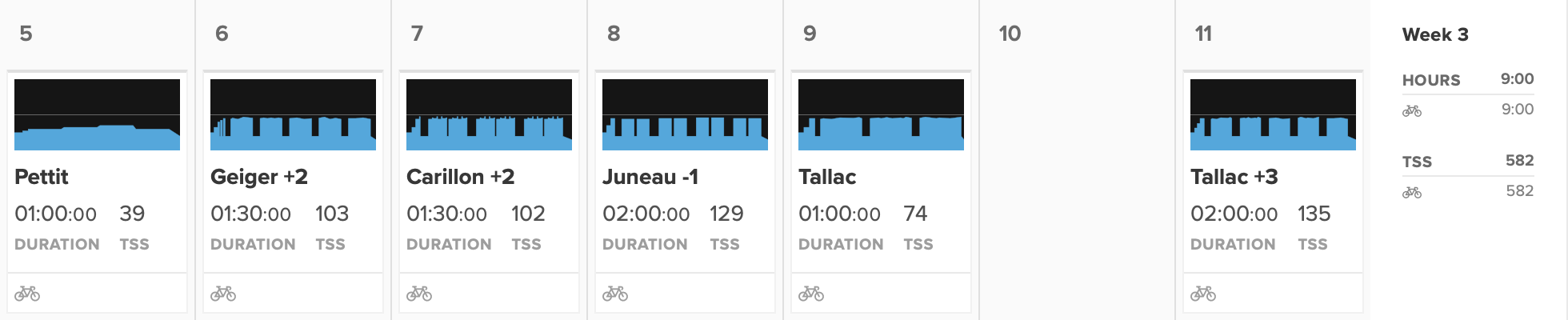

Here is the normal HV plan, and then I moved the easy day to Monday (skip) and Saturday totally free, and then you could maybe do all the workouts like normal.
Something like this? The example is from Sweet Spot Base - High Volume I
I would utilize the variations of workout (+1/-1) to increase the TSS and volume of certain workouts depending upon the day. There is an open feature request for more modification within plans that we’ll hopefully introduce soon, but in the meantime, you’ll have to manually add workouts or variations to get the volume you’d like!
