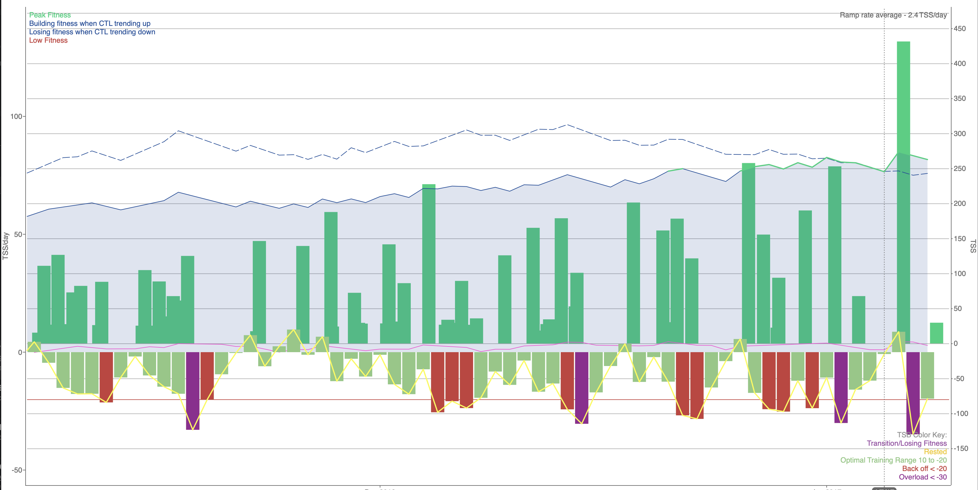

Two examples. 11 weeks in base below. TSB scale on left, mostly negative numbers. Individual workouts are positive bars, TSS scale on right.
I learned to ramp TSS around 2-3 per week. Learned that my best training is between 0 and -20, and to backoff when TSS drops below -20.
More aggressive stacking example
Ok, moving on.

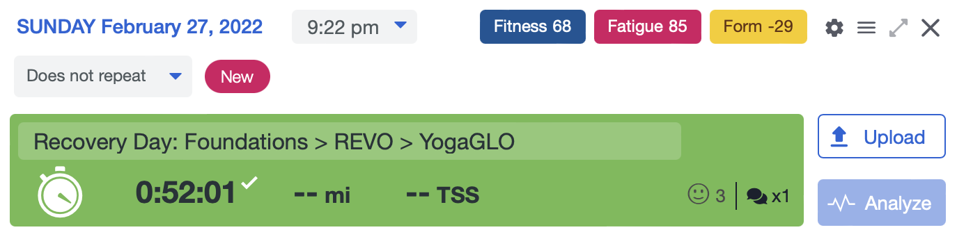

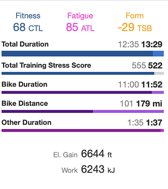

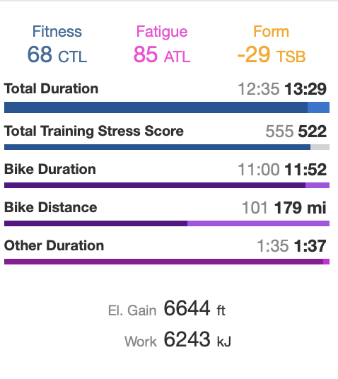

Using TSB to rearrange workouts, pay attention to the (negative) -29 TSB:
for that week:

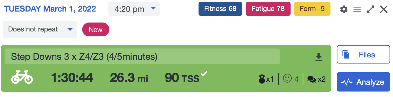

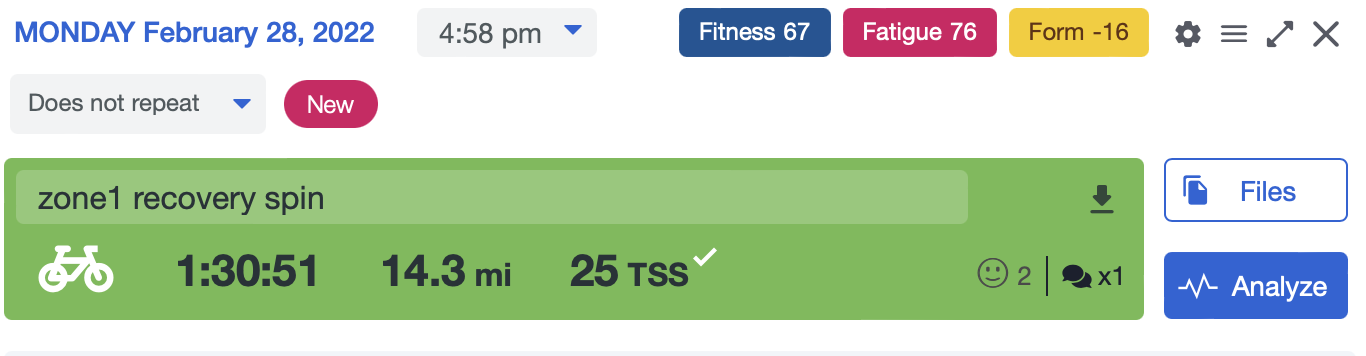

next day:
