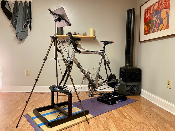

Have you changed the KICKR height setting to account for the way you raised front end?
If you setup the Kickr/Eflex as documented in the Eflex instructions, which says to put the kickr in the MTB 24" position, the bike doesnt sit level (the front end is too low).
I did the same thing as chindogu, placed a 3/4" board under the fork stand.
There is one lower position on the kickr that may also get the bike level (the RD 24" setting), but I didnt want to try it for fear of throwing off the balance of the EFlex.
Hmm, not seeing that here. Just pulled out a tape measure:
and both front and back axles (mid point) are roughly 13.875 inches off the ground. Will take a closer look later.
