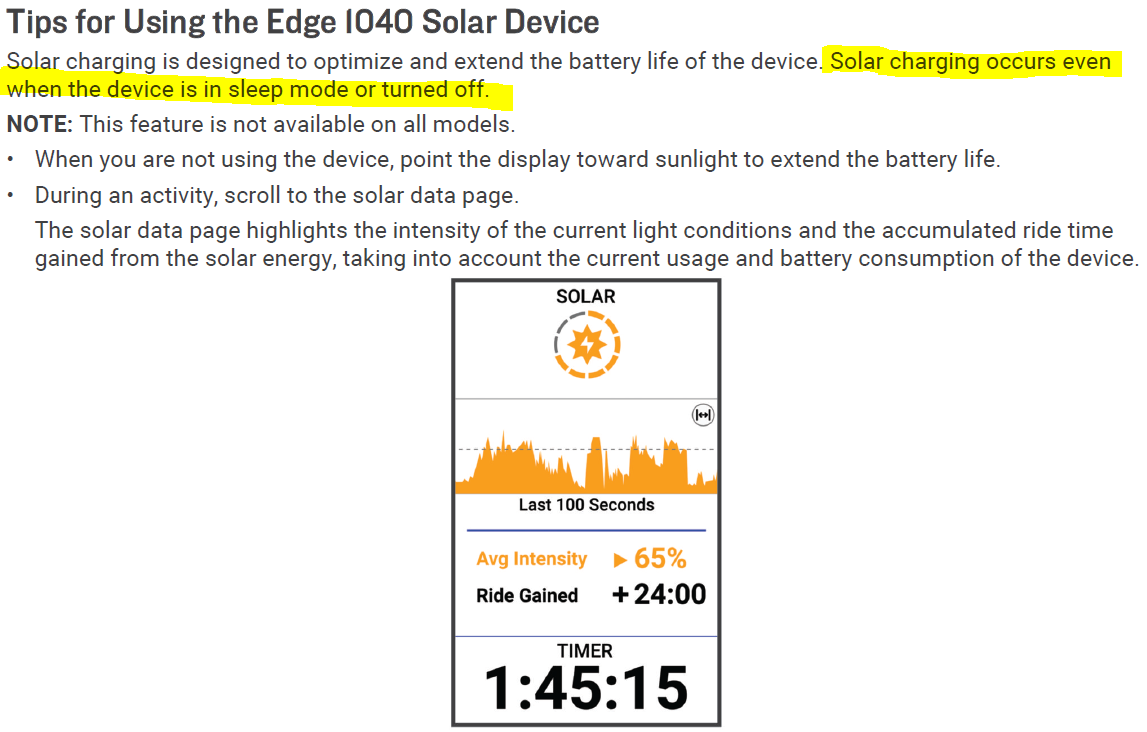

Got my hands on a second brand new Edge 1040 SOLAR and it also does NOT charge through solar energy when powered off or in sleep mode! So two different units, tested over multiple days, powered off or placed in sleep mode, zero battery gain.
Temperatures tested: 50-70*F
Battery levels: 60-70%
All day full sun exposure outdoors (not behind a glass or indoors)
Software version: 16.13 (most current as of today)
On the 1040 forums this has been discussed to death. By discussed I mean people saying “me neither” and getting angry about it. Anyone saying it does work, don’t believe.

Is it supposed to?
The Edge 1040 Solar is marketed with solar charging when powered off or in sleep mode. In the 1040 Owner’s Manual, page 76:
I wonder if that’s copied from the 955 Solar and just missed review.
Doubtful. Garmin support has been troubleshooting this and it’s been escalated to their engineering team. This is a known and documented issue. Very curious if Garmin will make the same claim with new Edge Solar 840 and 540 models. From my conversations with them, they may change the language.
