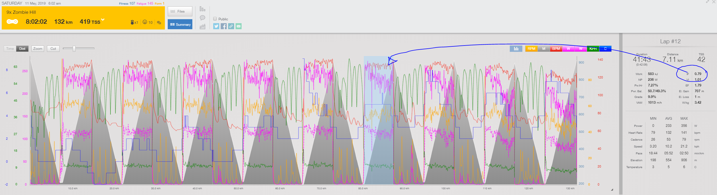

When “if” is discussed are we talking about overall or the uphill sections?
Very good point regarding Intensity Factor (IF). I mean overall for the entire ride, so I suppose you safely can stay somewhat above going uphill. I briefly checked my previous everesting attempts in TrainingPeaks, and it seems I venture close to 0.80 going up. Below is a screen shot from my one of my rides where I ended up with 0.72 for an 8 hour ride (132 km, 6,400 climbing metres, 419 TSS, 5,300 kJ):
