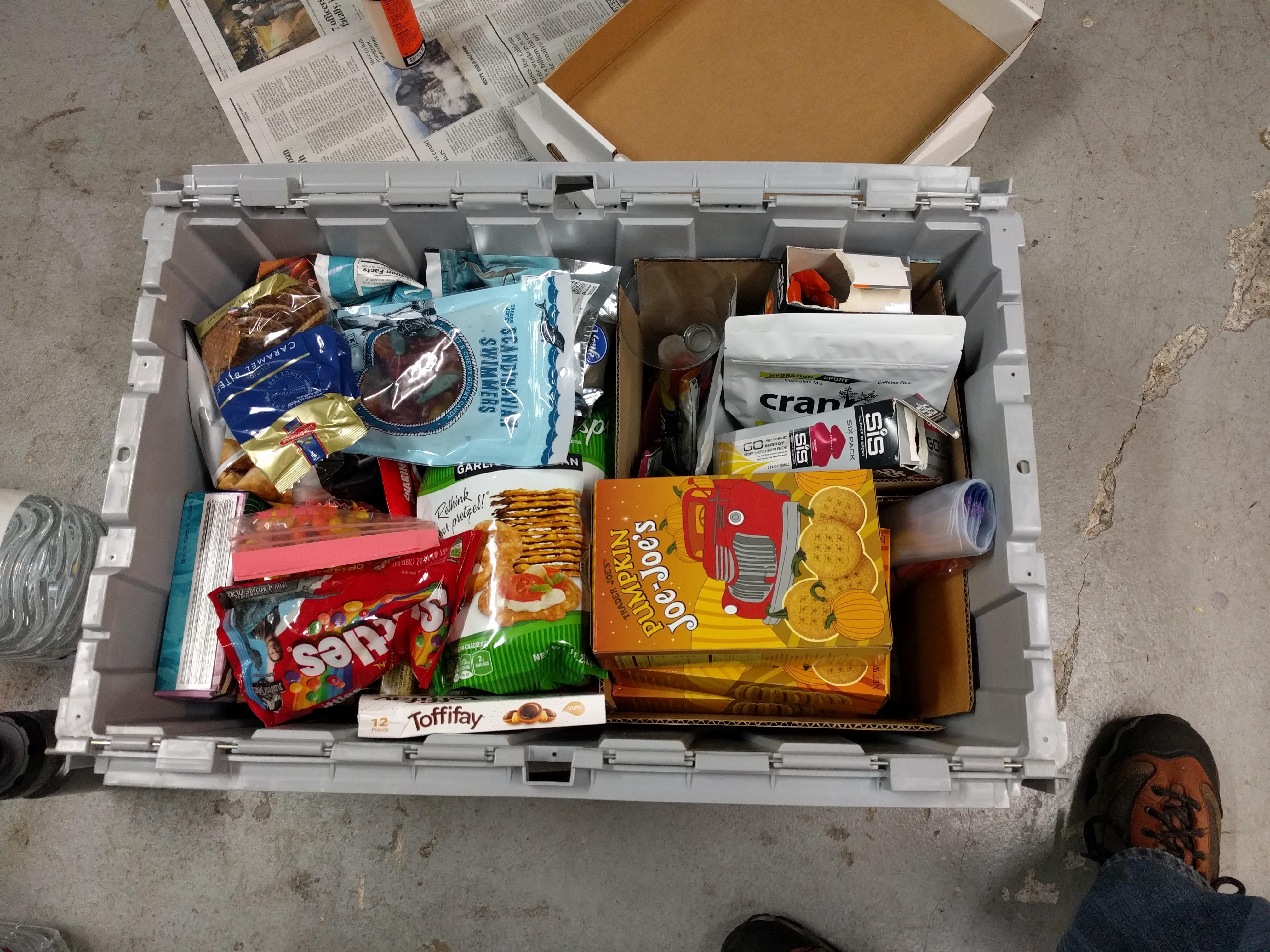

On the topic of food, I had quite an assortment for my everesting. I had a lot left over, but I didn’t lack variety.
My favorite food for the day was apple fritters:) It was very nice to have lots of choice for the 33 hours I was out there. I would recommend going overboard on the food if you can.
