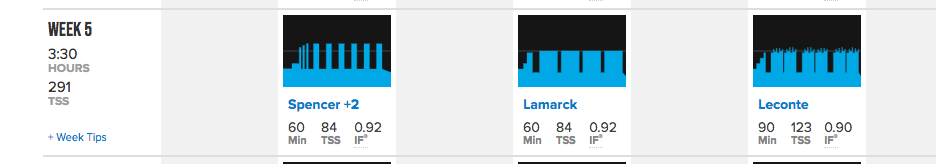

I’ve been thinking about this as I find the progression each week (even in SSB/Build LV) quite tough (>50, busy life, not used to structured training, 2.2W/Kg, 100 Kg).
I wondered about a week of 1* V02, 1* SSB, and 1* endurance (see screenshot)
So Baird-1, Monitor-1, Perkins. Gives an overall TSS of 225 in 4 Hours.
Would this work as plan?

It looks to me like you are creating something very similar to SSB Low volume but with a less variation and slightly more v02 work. The weekly TSS is about the same and in fact doesn’t go above 250 until week 5. So if you are tweaking intensity or FTP during your manual plan you’ll see a bump in TSS as well.

Perhaps I just need to toughen up and learn to cope with 291 TSS of week 5 of SSB II LV…
You’ve got a few options, you could run through SSBLV1 or you could jump on to LV2 and swap some of the workouts to the -1 or -2 version to bring down the intensity and hence TSS. Or you could give your plan a try.
