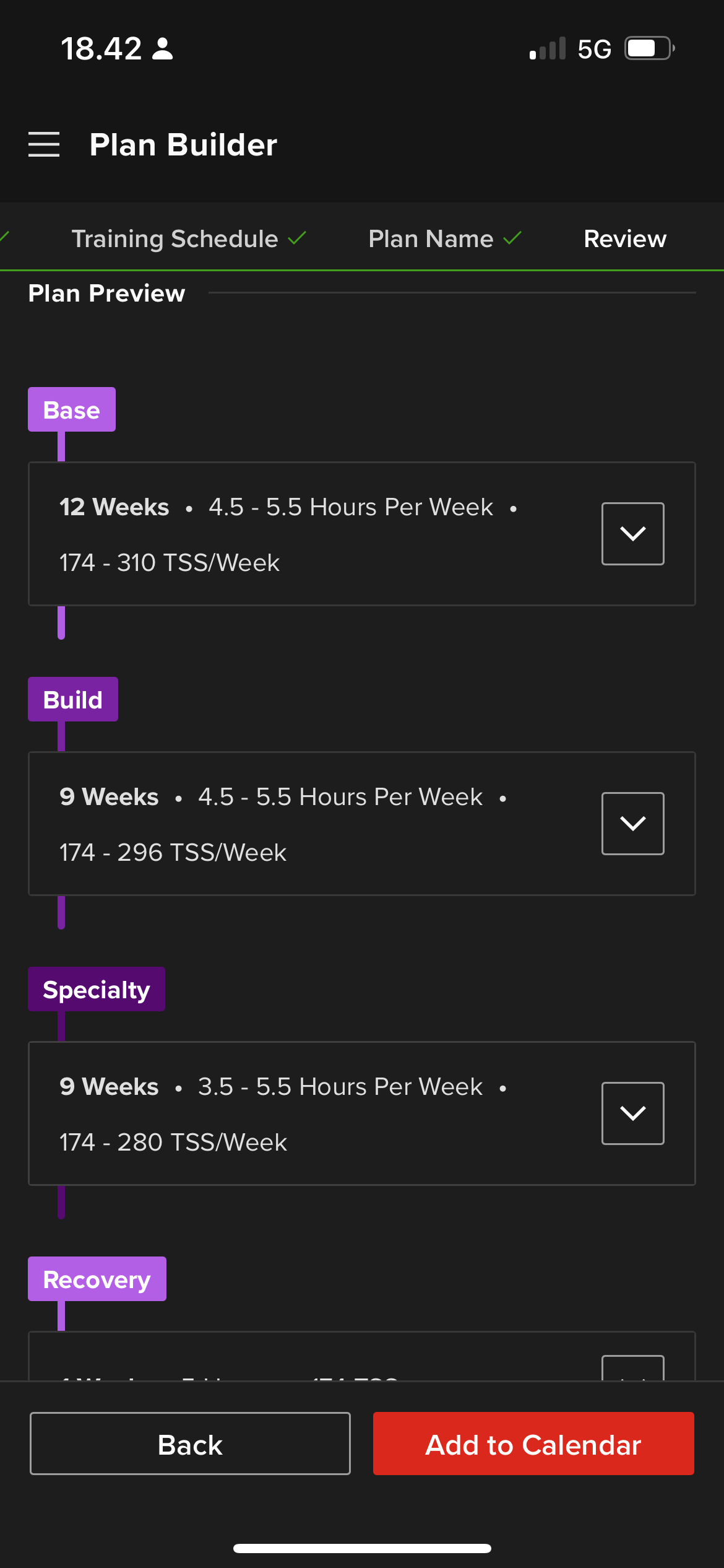

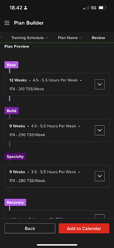

I did. But planbuilder suggest one long base/build phase rather than multiple cycles. Just wondering if that is most optimal rather than for example 3 phases each 3 months with base/build/speciality?
Its showing the standard 12 weeks of base, then build and then speciality. Not sure what you mean.
12 weeks of base, then 9 weeks of build and 9 weeks of speciality yes.
