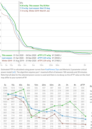

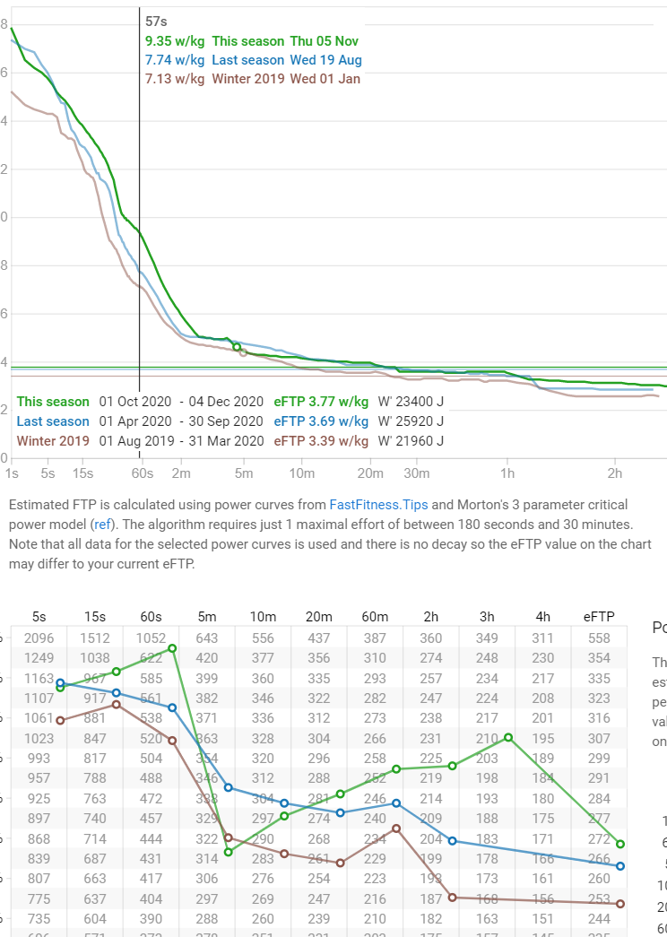

Here my Power Profile it bet ours the opposite. You are better about the longer stuff? VO2max is hard for me but I usually don’t fail them.
In your case i would do the Long stuff at the higer FTP and Dail the VO2max down to the % of the Ramp Test FTP
Nice short power! I assume you have never tested your 5 min or you are so much anaerobic skewed?

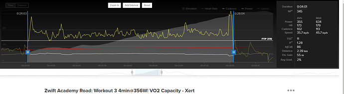

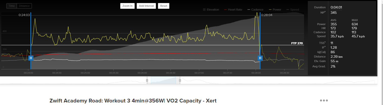

Yes i had a 4 min Test on the Zwift Academy recently , 5 min has been a while. And the 4 min really where all out. After that is where i am currently working at to get better SS and Threshold. The stuff you are very good at :slight_smile:
I am just asking because your 1 min power is like my 1s :wink: And it is always interesting to see completely other side of things.
Yes it is fun for some short Kom outside. But rather have my 1hPower closer to my ftp.
