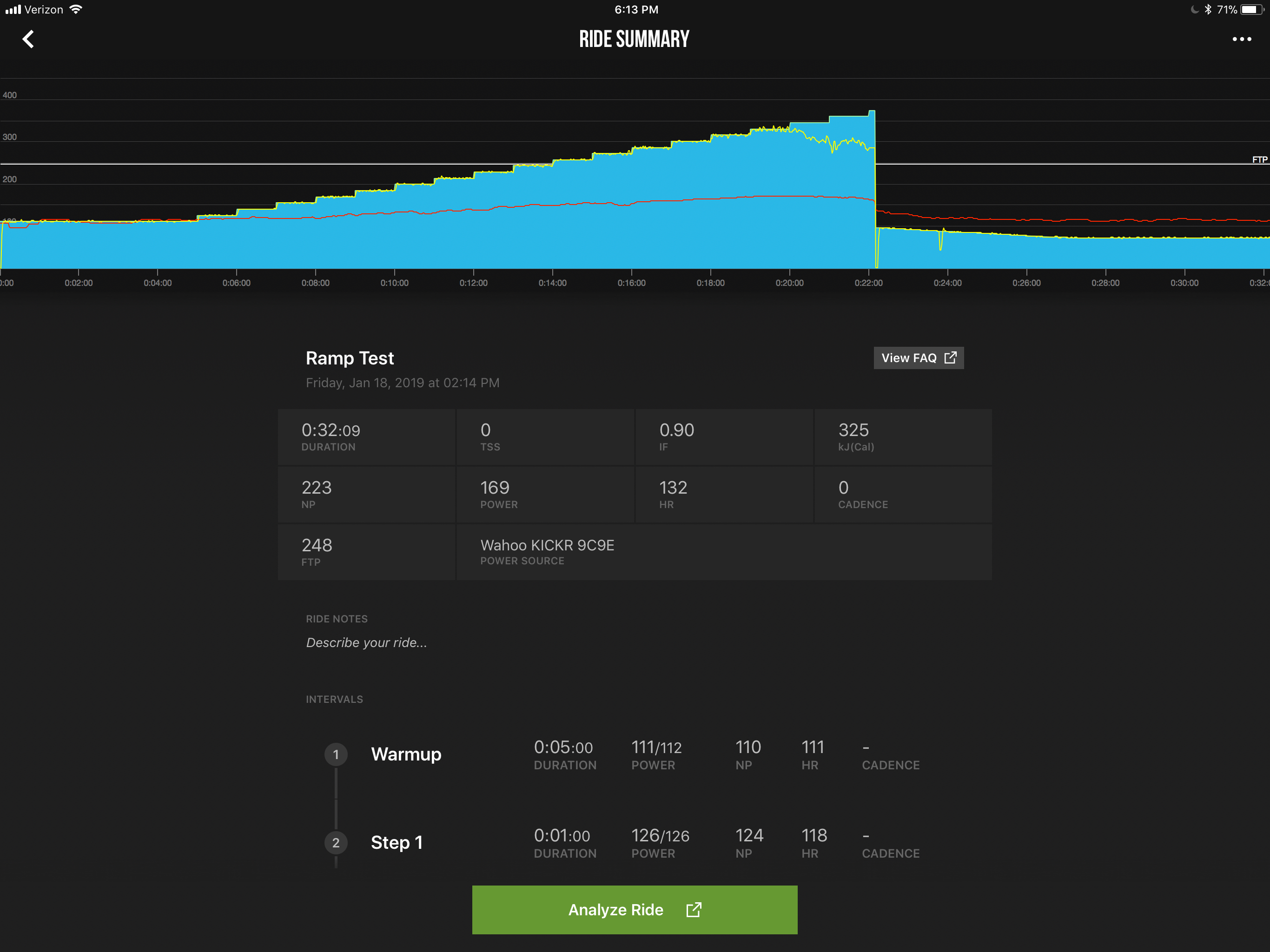

I just did the Ramp Test and decided not to look at the screen as I thought I could go longer just concentrating and listening to my playlist. I am on a Wahoo Kickr in Erg Mode. The last two steps went below the power required. My cadence did slow down, but I thought in Erg Mode, it would keep the same power threshold? I was trying to use all my glycogen up!
Can you share a pic or link t o the test for review?
How do I pull in the pic of my test?
Any standard screen shot method, depends on the device you are using (mobile, pc, mac, etc.)
