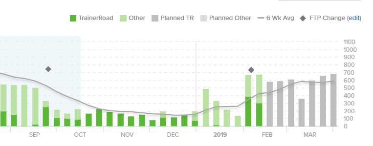

Here’s my TR cycling TSS. From mid-September to January I was doing about 400 TSS per week on the erg (not recorded in TR). In January I started to add cycling to get my cycling legs conditioned for the start of cycle training. You can see that the erg TSS should have been added as I was maintaining a weekly TSS of around 500 to 600. Jumping into cycling at 600 tss was no problem as the aerobic conditioning was the same for both sports.
