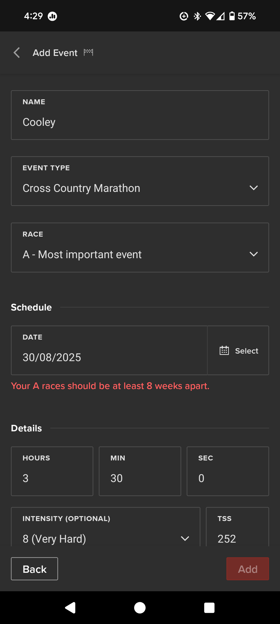

So I have an XC marathon on 30 Aug - I have added this as a B race (because it won’t let me add it as an A which it really should be)
It asked if I wanted to Keep my existing plan or Train for this event, I selected to Keep my current plan.
But - what it also should have asked is whether I wanted to Modify my existing plan to take into account this event - eg; by assigning the following day as a Recovery day.
Obviously it didn’t do this - why not?
Is it because it’s an A and not a B race?

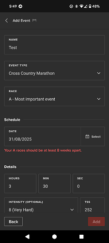

As you can see, it’s not letting me add an A race to the desired date
Whoops! :man_facepalming:
I miscounted there. That race is one day shy of the 8-week requirement between A races.
I’m curious, would it let you schedule it as an A race on the 31st? :eyes:
Afraid not
