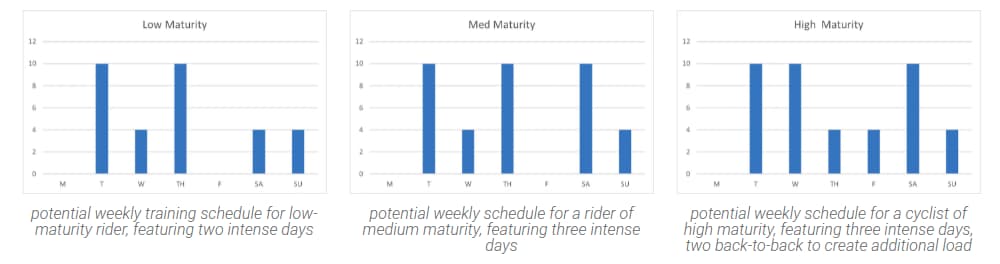

This reminds me of “block training”: By combining consecutively hard works with recovery, you can improve your cycling performance on a variety of levels.
From: Improve Your Cycling Performance with Block Training | TrainingPeaks.
Image: Polarized Training Simplified
