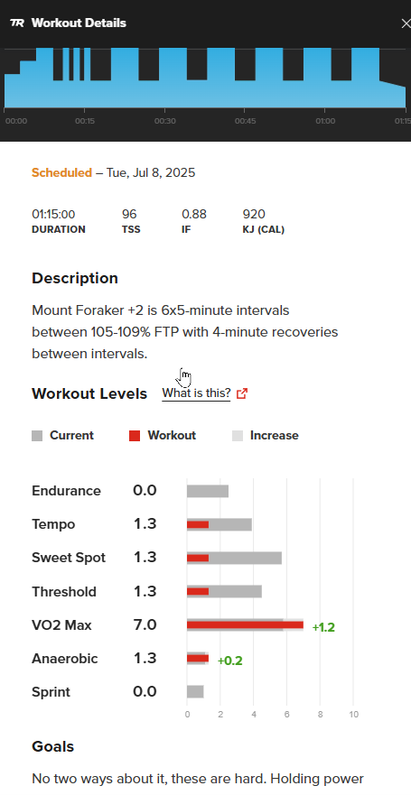

I must have missed a communication/update on this but I recall upcoming workouts used to have a Difficulty Level assigned to them eg; Achievable, Productive, Stretch, Breakthrough etc.. but I don’t see this anymore.
Case in point being tomorrows workout, which is a VO2 Max 7.0 Progression Level vs my current PL which is 5.8, I would have expected to see this identified as a “Stretch” Difficulty Level.
It looks a bit daunting to be honest, so I’d feel better substituting it for something a little lower if I knew it was rated as a “Stretch” Difficulty Level.

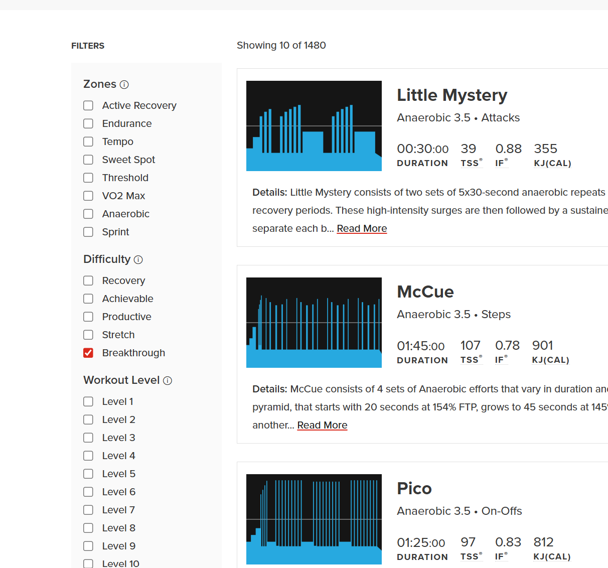

I don’t think its in individual workouts anymore but its still there in the filter and alternates.
My understanding (based on previous threads where people commented on TrainNow suggesting workouts far above their current PL) is that the algorithm has evolved so that if you’re getting a 7.0 in your calendar it’s because it thinks you can handle it. I suspect they removed the labels because they’re not really accurate anymore—if you can handle this workout, is it really a “stretch”?
I’d just give it a shot and see how it goes.

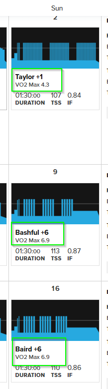

I recently did VO2 Max Thimble +2 workout but I didn’t really pay much attention to the PL rating of 7.4 for this workout.
If I had checked my current progression levels, I would have seen my current PL for Vo2 Max was 3.4, obviously this is a very big delta.
Since I had not done any VO2 Max workouts TR reduced my PL from 4.3 to 3.4 on 18/Oct. My last VO2 Max workout was on 21 Aug with a PL of 7.1
So it makes sense that TR drops my Career PL since I’d done very little VO2 Max workouts in the past approx 2 months, but throwing a 7.4 session at me was a little cruel I reckon :slight_smile:
Anyway, off I went into the first set of intervals (3 sets of 7 in this workout), I got through them (target was 367w and I hit that except for the 7th one where I got 360w) but felt that they were excessively hard.
Next interval I only got 358w and really struggled with it so I knew then that I’d have to drop the intensity (to 90% which equates to 330w) in order to complete the rest of the workout.
Nailed the rest of the intervals (possibly could have upped the intensity a few % but said I’d leave it) and just to spite myself I went hard on the last interval to average 384w.
So in terms of scoring for the workout, my PL did not increase at all (still at 3.4)
While I did drop the intensity to 90% after the first set of intervals, I still hit 347w average out of an original target of 367w, this equates to nearly a 95% completion performance. It’s a similar figure when you compare TSS and IF target-to-actual figures.
Thus I expected my PL would have increased somewhat above 3.4.

A point of note is my upcoming VO2 Max workouts, do you think they seem like they have taken my Thimble +2 workout performance into account? appreciate any comments :slight_smile:
