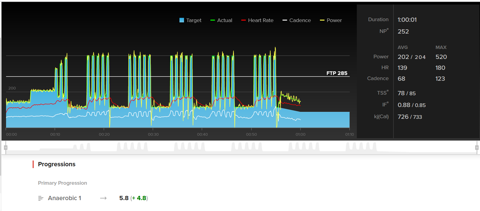

Hi, I do not want to change the subject of the thread so please point me to the right one if this is an off-topic.
Today I tried Sleeping Beauty +6 (5x30/30) but with a twist, I copied the workout in Workout Editor and increased 5% the hard intervals out of vanity so that the “on” interval target wattage was 400 watts instead of 385.
In the process the workout type changed from VO2 max to Anaerobic, therefore at the end of the (successful) workout, I just got an increase in progression level of Anaerobic. For me makes no sense that suddenly I just get better in anaerobic and not on VO2 max if the base workout is VO2 and I increase the wattage of the hard parts leaving the duration, rest between intervals and other parameters unchanged.
Thanks for the insights!
Well, despite the VO2 Max categorizing label of the SB+6 original, the work efforts are at 135% of FTP. That would place those intervals squarely in Anaerobic Training Level/Zone based on the typical Level split point of 120% of FTP between VO2 Max and Anaerobic Levels (Coggan).
Interestingly (and often confusingly) TR has set some Workouts Level Labels based on the intended Training Level for adaptations within the TR system vs a more strict definition of the actual work intervals percentage within the entire Training Level spectrum.
Then we have to add in the fact that using TR custom workouts are not officially supported within AT at the moment. As soon as you duplicate and modify a workout, I don’t think we fully know what to expect. This “re-categorizing” to the Anaerobic Level label, (after you added 5% to hit 140% of FTP in the work intervals), actually makes more sense to me (matching regular level splits) than what TR is doing with the interesting labeling of the original SB+6.
