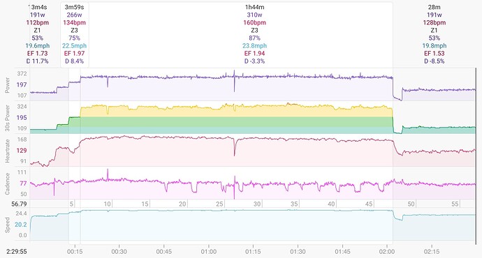

How else are you going to find your TTE :man_shrugging:t2:?
I suppose the question is “How is that going to inform your training?”
One week you might hold 310 watts for 50 mins, a week of rest and you might hold 315 watts for 65 mins before failure. Which one is your TTE and which is your threshold, does it matter?
In a different ride. If you do a KM FTP test, once you get into the final portion you’ll be in a slow, progressive ramp that will likely end up with you riding above threshold power.
As a result, it’s probably not as good a way of finding your TTE as, say, just riding an open-ended interval at 98% of your current FTP.
Do you need to know your TTE within a gnat’s backside?
Some people do. Others do not.
But to answer your question about how else are you going to find your TTE… long intervals.
My true TTE determination sets have usually come on days where I felt really good and I just skipped the rest interval on a 2x30 or something like that. Most of my TTE/FTP tests involve a bit of “speculating”, so I might ride up above threshold for a little while, figure out that’s too high, and dial it back, then ride to 40 minutes or whatever… but that’s not my true TTE if I spent some significant amount of time above FTP.
Case in point, coming out of my VO2max block, I had a testing day where I went out thinking FTP might be 300+W based on WKO5 and data and such… I started my test holding 300. About 8 or 9 minutes in I knew that was too hard, so I dialed it back, found where it felt like I could sustain things around 285-290W, but the damage had already been done. I finished averaging ~290 for 20 minutes. Two weeks later, I rode 50 minutes at 290+W. Was it a good day? Was it just better pacing? I think a little of both.
Essentially the same thing, but you might not have a great day on your actual testing day, but it’s really common for me to see TTE move out in my training and my athlete’s training during extended interval sessions which are targeted at or slightly below FTP.
