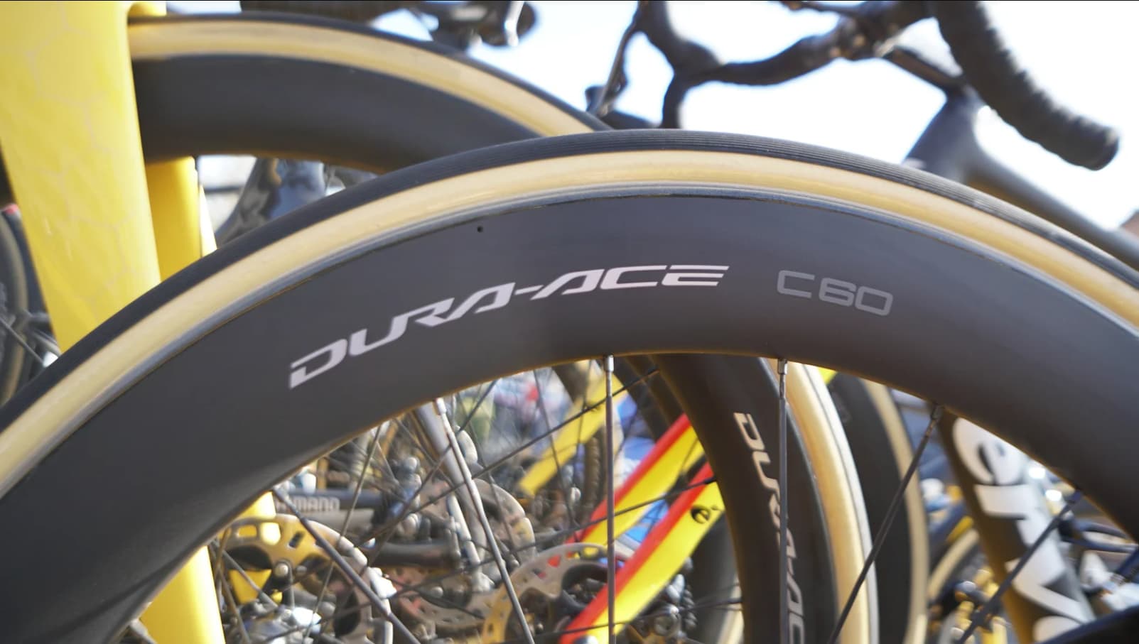

How come to major tire manufacturer picked up on the idea Mavic had in 2012 and made a smoother tire/wheel interface.
E.g. Mavic Cosmic CXR80 Gallery - Slowtwitch.com
It seems like such an obvious thing to do in todays age when everyone is looking for marginal gains.
Even Jumbo picked up on the concept last year but it got little to no media attention suprisingly. It looked more like a DIY hack than something you could sell to a consumber to be fair.
It’s just curious how every serious time trialist knows about the how different high end tt tires perform aerodynamically but the industry doesn’t pick up on that trend go one step further.
