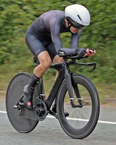

As an aside as mentioned above I managed 1:51:37 for 50miles off 233W on 4 laps of the same course (the F2/25 and F2/50) in Cambridgeshire if you live in the UK - which is 26.9mph. Plus 20:32 for 10 miles which is 29.22 mph off 264W - so the answer is less power than you think if you are not big and get aero. Plus I had an aero bike fit yesterday so I’m aiming for a 30mph 10 next year off the same power… :pray:
Yep - it’s the Exocet 3 from Planet X - it doesn’t seem to be sold anymore and is a lot less common than the 2 which was around for years - does the job and didn’t require a second mortgage! :grin:

Thanks - I use Conti GP5000 25c with latex tubes - I did use Corsa speeds tubeless for a few races last year but I got a sealant leak in the carpark before a hot TT last year and don’t trust them - according to the Bicycle rolling resistance website if you use latex tubes the GP5000 are only about 1.5W slow than the Corsa speeds and they are much more robust. I wear a Nopinz flow suit which is a seriously quick bit of clothing along with Castelli fast feet overshoes which as you can see double as aero socks! :grin:
