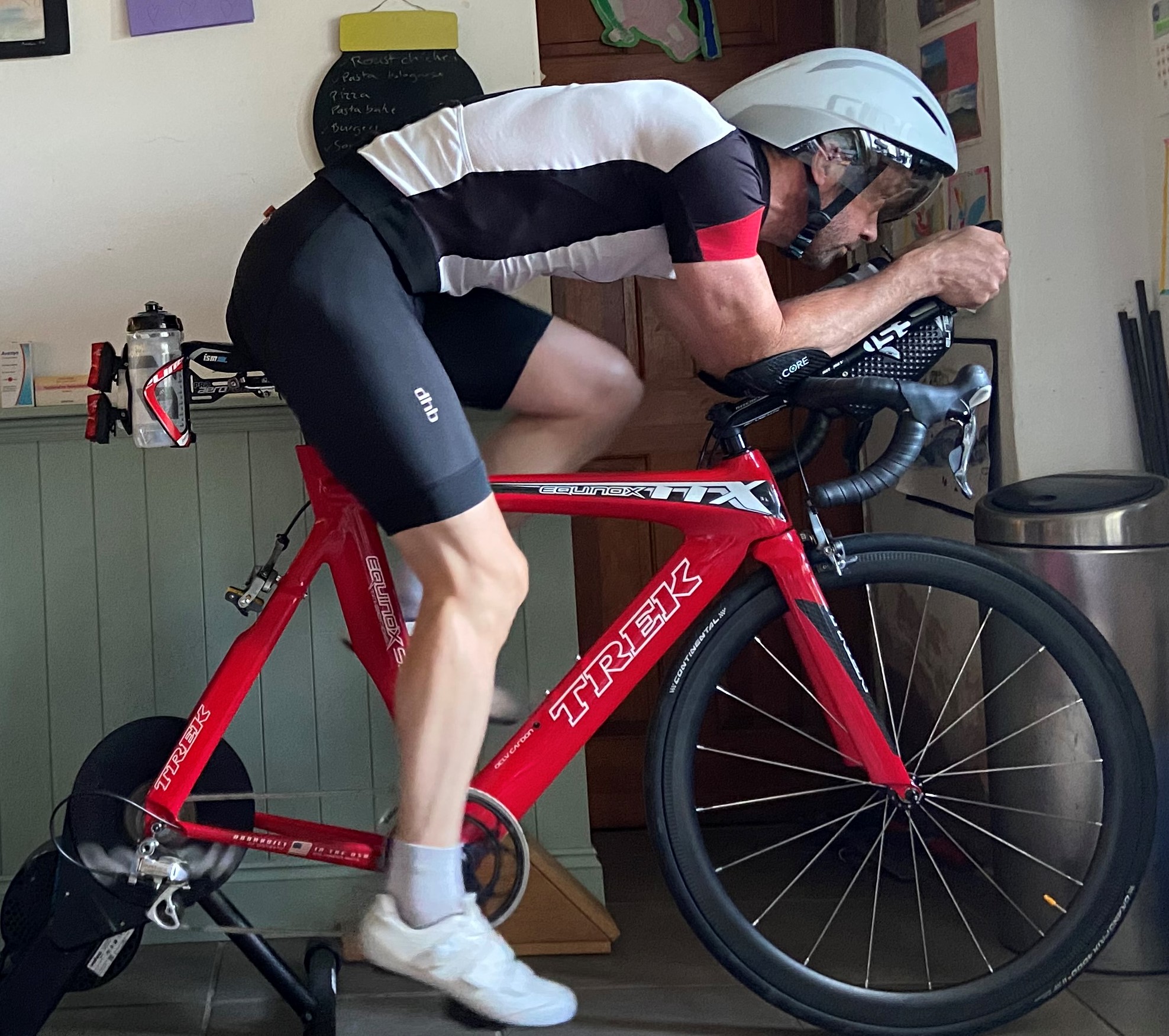

I’m sharing a couple of pics of me on 2 different bikes, as much for interest and general amusement as anything. The black bike is my ā€œshortā€ TT rig, the red one is a bit of a frankenbike, but with long distances in mind. I’ve largely taken the position on the black one as a known ā€œgoodā€ setup and rotated about the BB to produce the red one. The improvements on the red one are less weight on my arms and better handling with less weight over the front.
As per @kevistraining - wrong bl00dy helmet, I think. Maybe we should set up a TT helmet rotation pool? :grin:
Please excuse the cr@p in my kitchen.
