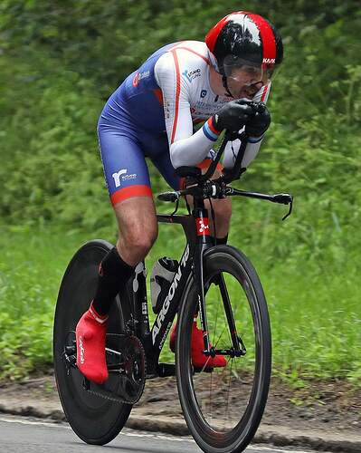

In my head I also lose time sitting up for defects/bends and traffic too often. Especially like this.
IMG_20210619_225143_529

Edit: Side on shots:
It looks like you’re slid really far forward and smashed up in the front up causing your head to be much higher than ideal.

@HLaB - I have just looked at your pics again, and a few things strike me.
  1. Your elbow pads look… awful, sorry. There is barely any side to side location and no front-rear. No wonder you feel precarious on downhills. I would really recommend something like this (or the cheaper plastic one). I am sure you will feel a lot more stable/secure, hence able to steer/control better:
    CORE:cupCORE:pad | coretriathlonCOREtriathlon.com
  2. I definitely agree with what @DarthShivious says. Those base bars are already very aero, reducing further will give you the square root of FA.
  3. I think your saddle is too high. The 3rd pic is blurry, but your leg is very straight. If this means you rock your hips/reach with your toes at the bottom, its not going to help. In the 4th pic, @JT_34 is right, you are too crunched - but I think this is because you have come right forward on the saddle (possibly because its too high!!) and hence your shoulders are too far over your elbows, hence you can’t sag your head down.
@rawjunk - the biggest positional thing I think you could do is learn to turtle and sag. In the front-on shot particularly, your head is way above your shoulders.
I think it may be covered up-thread somewhere, but you’re looking for an elbow position that allows you to totally relax your chest muscles and allows your shoulder-blades to move inwards/together. You can practice this when off the bike/standing up by pulling your shoulders right back and (if you’re flexible) seeing if you can get your shoulder-blades to touch in the middle of your back.
On the bike, you’re looking for the same thing, but with much less muscle involved ('cause gravity is helping you). And then see if you can press your chin between your thumbs. Seriously.
This should all have the effect of moving your head down a lot, and rotating it forward to improve your view and also close up a bit between the back of your helmet and your back, although with a road helmet this is always going to be a gap.
I’ve been practicing that but you can’t really see that in the picture :sweat_smile: Maybe I’ll try foam rolling and scapular pushups before next ride.
They are cheap arm rests stolen of a pair of cheap clip ons. They were only supposed to be short term to see if the position was more comfortable on my wrist (it is) I really meant to change them but got to comfortable with them. This post has reignited that desire, thanks.
I think the saddle is the right height. Its been dropped by a couple of fits and it feels spot on and there absolutely no rocking.
