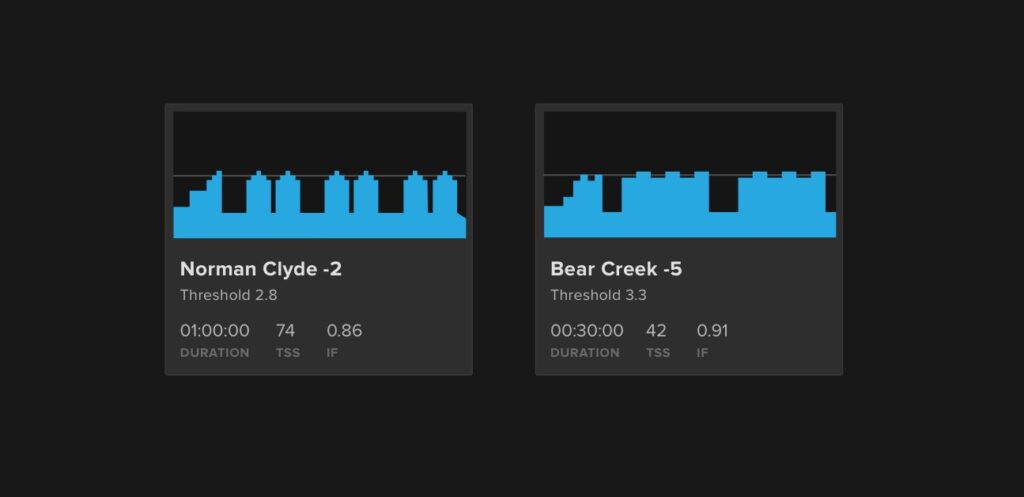

TSS (Training Stress Score): a Measure of Your Hard Work
What is TSS
TSS, or Training Stress Score, is a description of how much physical stress a workout places on the body. Tracking TSS allows us to balance adaptive stress with proper recovery, helping to maximize the outcome of your training. Riding at FTP for one hour results in a TSS of 100, but both intensity and duration influence how this metric is calculated.
How TSS is Calculated
The intensity factor (IF), Normalized Power (NP) and duration of a workout determine TSS. Intensity Factor reflects the relative intensity of a workout as compared to your theoretical maximum, based on your FTP. The actual calculation used to find TSS is:
TSS = (# of seconds of the workout x Normalized Power x Intensity Factor) / (FTP x 3600) x 100
Note: If you’re wondering what that “3600” represents, it’s the number of seconds in an hour; “100” is there because riding at FTP for an hour generates 100 TSS.
In TrainerRoad, every workout is listed with a planned TSS value, and completed workouts include measured TSS compared to this expectation. In addition, weekly TSS is visible in the Calendar view, alongside each week in list form and in the Training Stress graph.
Why TSS Matters
Knowing how much physical stress a workout generates allows you to estimate the potential fitness you’ll gain from your training session, given adequate recovery. TSS is a way to measure this stress. In addition, looking at TSS and how you respond to it over time can help you better fine-tune the volume and intensity of your training. Any time recovery is hampered or performance isn’t in line with expectations, reviewing TSS can help find the source.
It’s important to note that while TSS is an extremely useful metric, not all TSS is created equal. A high-TSS workout does not guarantee an increase in fitness, as intensity and duration both factor in and don’t stress your body equally. For instance, a relatively easy two-hour ride and an extremely intense workout of under an hour can result in the same TSS. These workouts take very different tolls on the body and spur different physiological adaptations. So, while total weekly training stress is meaningful to know, IF (Intensity Factor) is necessary for context. Workout Levels are a new metric that combine TSS and IF to measure the actual difficulty of workouts. TrainerRoad plans are all quantified by TSS, but individual workouts are strategically arranged within a training plan using Workout Levels to manage fatigue. Learn more about TSS here.
