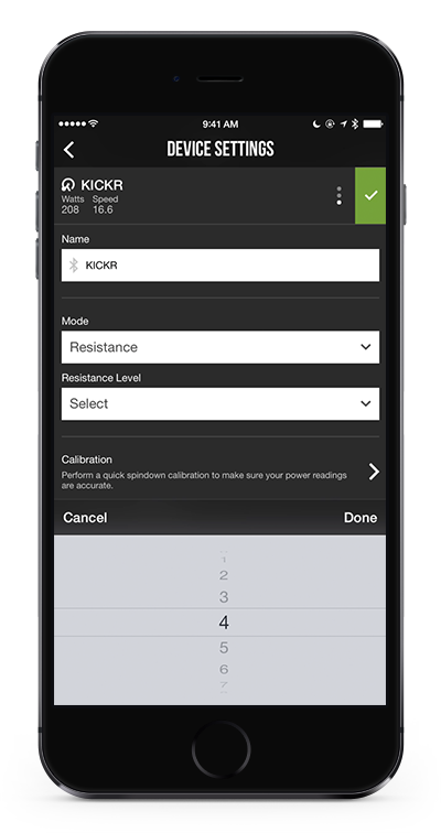

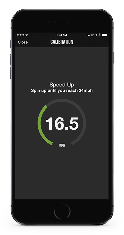

KICKR Spin-down and Mode Control
TrainerRoad 4.0 gives you the ability to manually control the different modes of the Wahoo KICKR (Erg, Resistance and Standard) and perform a spin-down calibration from within the app.

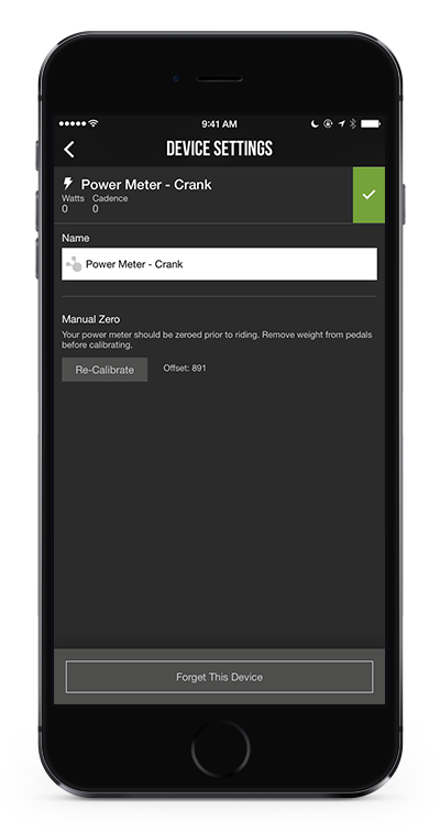

Power Meter Calibration
ANT+ power meter owners can do a manual-zero offset calibration with the new app, and we’ve improved stability and pairing with SRM power meters.

I use iPad Mini with Kickr.
Tap on Devices- Tap on Kickr and Calibration/SpinDown
Is there below the Mode settings in small printing.
Just tap on that and up it comes. Very handy.
