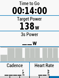

Customizing Data Screens for Structured Workouts
Garmin shows a built-in Workout/Target screen with your current step, target range, and time/distance remaining. You can also add your own data screens per activity profile so you always see the metrics you care about (e.g., 3-sec Power, Lap Power, Avg HR, Cadence, %FTP, Time to Go).
How to customize (typical Edge flow):
Activity Profiles → [Your Profile] → Data Screens → Add Screen / Edit Screen → choose your layout & fields. Keep the default Workout page enabled so you still get the target gauge and countdowns.
General Screen Suggestions(keep it simple):
  • Workout/Target page (built-in): step name, target gauge, time/distance remaining (leave as is).
  • Power Focus page: 3s Power, Lap Power, %FTP, Cadence.
  • Context page: Heart Rate, HR Zone, Speed, Elapsed time.
The default Garmin workout screen shows step details and targets, but customizing your data fields can make hitting your intervals easier and more effective. Below, you’ll find optimized layout suggestions for each major Edge model, so you can see exactly what you need, without distraction.
