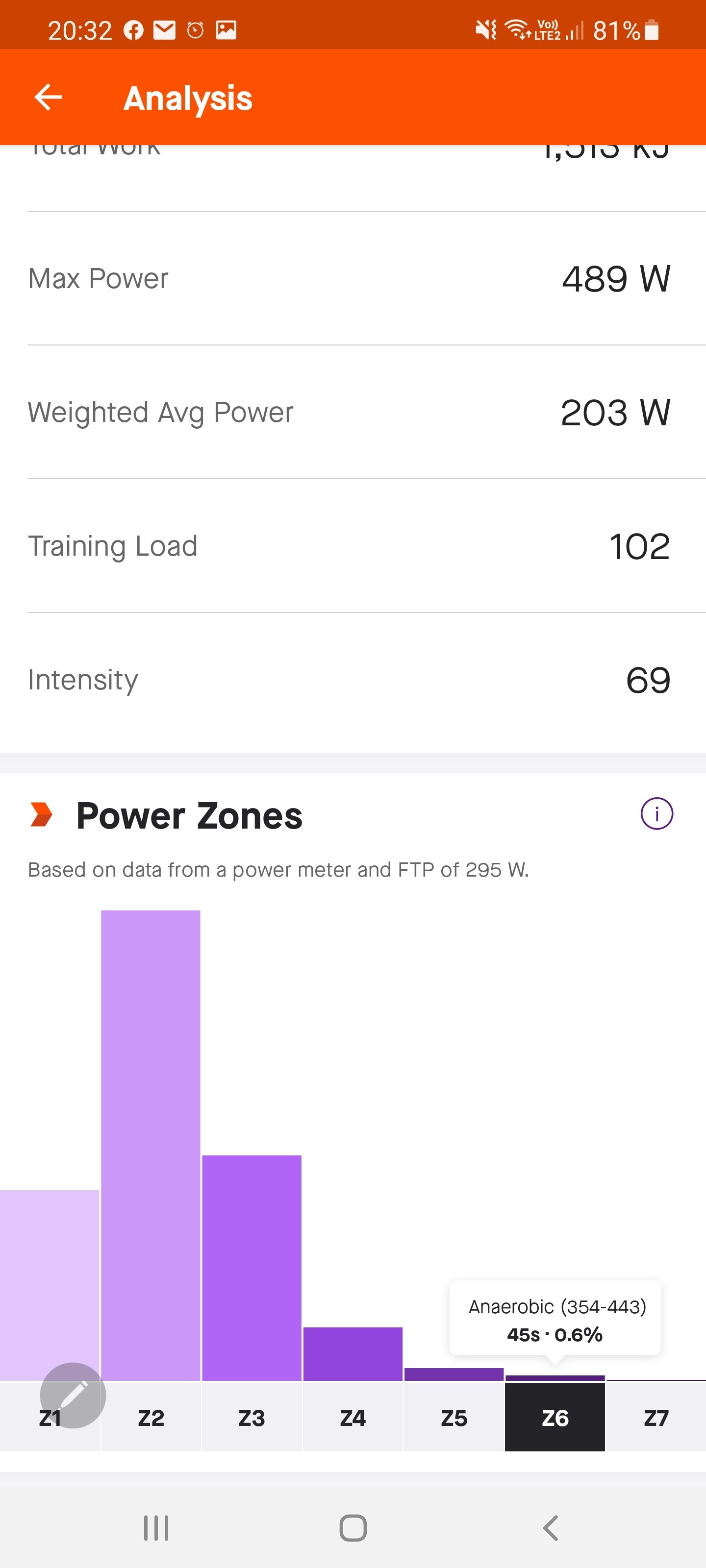

I’ve just signed up for a Trainerroad account, put in all my details including weight and current ftp of 295. All my Strava rides have been synced with the Trainerroad calender. When I select the ride I did today which was an easy zone 2 one and I click on “analyse”, it takes me to the Website. All fine, apart from the zone analysis.
The wattages for the zones are all wrong. The Anerobic zone is showing as 242 watts. I’ve checked my account and its showing my 295 ftp. What’s going on?

Thanks for your reply, but I’ve literally hjust started with TR today so there is no history at all. I’ve done what you’ve suggested and you’re right, the ftp is set at 200 for all rides that have been synced from Strava. Why on earth would it set it them at 200? I wonder if I can change the historical ftp globally rather than do each individual ride.

Or add historic FTP and your problem should be solved. Account → profile → FTP history. And yes, 200W is default FTP.

Yes it does thank you. Its all sorted now.
